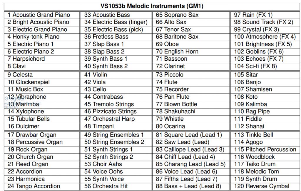

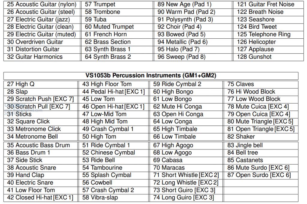

Hi all.
I have an idea for a MIDI sound machine using a VLSI codec chip(VS1053B).
The spec is 8-bit WORDS, but 10-bit BYTES made up of a start-bit, followed by eight data bits, and finally a start/stop bit for framing. See the link above for even more technical information.
The 1053 can also play OGG/WAV/WMA/MP3/MP2 and just about anything else you can throw at it(including FLACC with external DAC), but I am most interested in it for it's MIDI synthesiser. Complete modules can be had on eBay for about US$5 a board from listings like this one.
The device talks to the host MCU using the SPI port, so my first thought was the standard MMBASIC SPI commands, but that does not support 10-bit SPI, only 8, 16 or 32. Next, I looked at the SPI Cfunction, and it DOES let you specify any number of bits per byte up to 64, so this is the one to use.
The 1053 gives you access to the following instruments and also a good selection of drum sounds, so a MM-based drum-machine might be coming(using other MM input pins for sensor pads).....
Do any of the technical boys and girls here see any OBVIOUS problem with this concept as it sits now? Perhaps other members have even better MIDI synth chips they know about? Please post if you do.

Posted: 06:52am 05 Jan 2018
MIDI is serial at 31.25Kbps. It is 8 bits of data plus a start and stop bit. This is a very standard serial transmission as a specific bps rate. The hardware interface uses opto isolation to stop those dreaded ground loops in audio systems.
I worked with MIDI quite a bit back in its early days. I designed several high end controllers (back in the 8bit days) using multiple independent MIDI out ports when the Roland MPU-401 could only do 1 output per box. This was needed to try and reduce the latency of talking MIDI to several synths in a studio setup and keeping them within experienced muso's acceptable timing delays.

Posted: 03:31pm 05 Jan 2018
https://moderndevice.com/product/fluxamasynth-shield/
or
https://www.sparkfun.com/products/10587
work real well and add the ease of using
an Arduino shield (if wanted)
