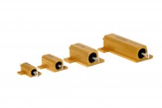

I would use one or more of those "gold" metal clad resistors that can be bolted direct onto your plate.
These can then be switched on or off with a mosfet.
Any one of the switched mode power supply control chips could pwm those mosfets directly. And the error amplifier in the controller connected to a temperature sensor.
The pwm switching frequency need not be high, 100 Hz switching rate would be fine for something like this. Edited by Warpspeed 2018-01-08

Posted: 04:08am 07 Jan 2018
They are a good solution where there is a fan, and you don't want the heating element to burn out if the fan fails. Unless your aluminium plate goes above 80 Celsius they will just act like a normal resistor of the specified power.
If your eggs ever get to 80C, they are not likely to hatch.....!
So I cannot see the point really.
A simple basic resistor would work just as well as a heater as anything else.
Bonding the resistor to the metal plate is the only complication, and those gold resistors solve that problem very simply.

Those gold resistors are expensive . NZ$4 and up each PLUS another $2 for freight for each one! I would need four or five(or more) to get even heat distribution. Using just one(or two) would be pointless, as you would end up with hot-spots where the resistors are, and the rest of the plate gets cold - this is the problem I have now with the resistors clamped to the plate. So I would need to use 6-8(maybe ten) of those gold resistors, and that is starting to get rather expensive compared to other options. You're looking at $40 or so just for the gold resistors, plus another $20 in freight - we're up to sixty bucks just for the resistors so far.
I will have another search on those. Perhaps I was unlucky to strike expensive ones or something, but the other choices just below that listing show similar ratings, and similar prices too!
EDIT: OK, this is interesting. HIGHER power ones are cheaper! I found these when I searched for '50W resistor' - fully expecting them to be almost twice the price of the 30W ones. Weather they are any good is another thing, but perhaps......Edited by Grogster 2018-01-08
