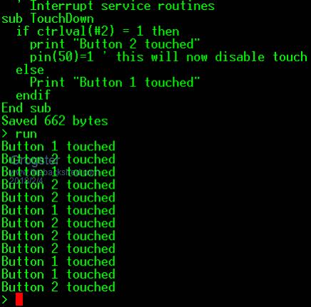

Using PM's 470 backpack, I have come across a problem that appears to be a bug?
I am running 5.04.09 running on a 64 pin 470 board with an SSD1963 7" display
If I try to use D13 (470 pin 50) on the Arduino shield which is SPI Clk as a digital out, as soon as I set it to 1 the touch function on the 7" screen stops working.
I have checked the board and the 7" display uses SPI2 which should mean that using SPI1Clk (the D13 pin referred to above) should have no impact on touch?
The code below demonstrates the issue - the top touch checkbox works as it should for multiple touches but as soon as the bottom checkbox is touched, all touch functionality stops and the only recovery is a power reset.
If the line pin(50)=1 in the touchdown interrupt is commented out, both buttons work as they should when touched.

Works OK for me.
No errors, no lockups, touch continues to work fine.

E64 module(same chip as you), 5.04.08
I have one permanently setup here with a 7" LCD on it for development, which is why I could test your code immediately.

T_CS is on pin 51. Maybe a bridge between pins 50 & 51 so when pin 50=1 then the touch T_CS pin won't pull low to select the touch.

Bingo! Got it in 1 Gerry - thanks and apologies to Geoff/Peter.
