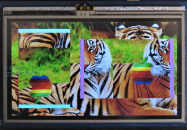

Please find attached MMX5.04.14 for 100/144 pin parts
2018-02-16_045942_MMX5.04.14.zip
and for 64-pin parts
2018-02-16_050002_MMX645.04.14.zip
Changes are:
allows OPTION LCDPANEL USER to be used in a program. NB this option is not permanent and needs to be set again after a reboot.
Implements new drivers for 16-bit parallel ILI9341, SPI ILI9341, SPI ili9481, and 16-bit parallel 4.3" SSD1963 using an in-memory framebuffer.
By default the Micromite eXtreme has 469K bytes of available RAM for use in user programs. This is much more than is normally needed given that the program is stored in flash memory and that will hold a program of up to 544K.
This release optionally uses some of that available RAM as a framebuffer for various displays in order to overcome some of the limitations of directly addressing the TFT display. This is best explained by watching a video of sprites running on a 4.3" SSD1963 display using a driver with and without the framebuffer.
The mechanism of moving a sprite is as follows:
1. replace the sprite with the stored background
2. scroll the background
3. save the background for the new position of the sprite
4. re-display the sprite
The effect of this can clearly be seen in the first part of the video where the sprite flashes repeatedly and is only barely visible between loops of the program.
By using a framebuffer, all of these steps can take place within the memory of the Micromite and only when they are completed the complete area affected is written to the screen as a single operation.
Of course this approach is not only useful for sprites but can make any sort of animation look much better. The user has complete control of when the screen is rewritten. By default each Basic statement that updates the screen will cause a write to the TFT panel (a sprite move is a single Basic statement). However there are two statements that allow the user to override this.
OPTION AUTOREFRESH OFF
will stop drawing statements updating the screen and just the framebuffer will be updated.
OPTION AUTOREFRESH ON
will cause the display to be updated to the current status of the framebuffer
So for example the pseudo code for updating an analog clock display might be:
REPLACE HANDS WITH BACKGROUND
REWRITE HANDS IN NEW POSITION
The new drivers are enabled as follows:
All MMX
OPTION LCDPANEL ILI9341_BUFF, orientation, DCpin, resetpin, chipselectpin
This uses 150K of memory leaving 319K for user programs (320x240x2 = 153,600 /1024 = 150). Time to write entire screen (cls rgb(red)) 29mSec. Time to scroll entire screen 49mSec
OPTION LCDPANEL ILI9481_BUFF, orientation, DCpin, resetpin, chipselectpin
This uses 300K of memory leaving 169K for user programs (480x320x2 = 307,200 /1024 = 300). Time to write entire screen (cls rgb(red)) 156mSec. Time to scroll entire screen 194mSec
100/144 pin only
OPTION LCDPANEL ILI9341_16_BUFF, orientation, DCpin, resetpin, chipselectpin
This uses 150K of memory leaving 319K for user programs (320x240x2 = 153,600 /1024 = 150). Time to write entire screen (cls rgb(red)) 10mSec. Time to scroll entire screen 30mSec
OPTION LCDPANEL SSD1963_4_16_BUFF, orientation, DCpin, resetpin, chipselectpin
This uses 255K of memory leaving 213K for user programs (480x272x2 = 261,120 /1024 = 255). Time to write entire screen (cls rgb(red)) 16mSec. Time to scroll entire screen 50mSec
