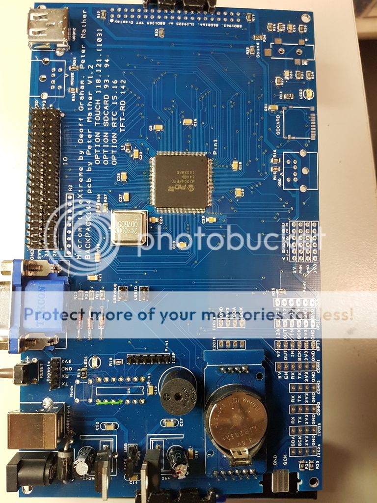

A few days ago I loaded a 144 pin MMX board mostly with components I had on hand and what I could purchase locally. Although I am still waiting to receive some components such as the SD card socket and audio socket I thought that I had loaded enough components to program the unit. I have not loaded the PIC16F1455 as I thought I could program with the PICKit 3 I have.
The problem I have is that the MPLAB IPE 3.50 does not connect to the chip. Here's what I checked:
Checked 5V rail OK
Checked 3V3 rail OK
Checked MCLR at high and reset pulls low and connects to pin 1 ICSP
Checked with CRO OSC is working on pin71
Checked Ground on pins 17,32,54,63,75,89,108,123,136 and 42 (AVSS) and connects pin 3 ICSP
Checked 3V3 on pins 18,33,55,64,88,107,122,137 and 74 (VUSB3V3)and connects pin 2 ICSP
Checked connection of PGD to pin 38 and connects pin 4 ICSP
Checked connection of PGC to pin 37 and connects pin 5 ICSP
I have tried powering the chip from the PICKit 3 as well as locally
I am at a loss to think of what else to check.
Hope someone has some ideas.

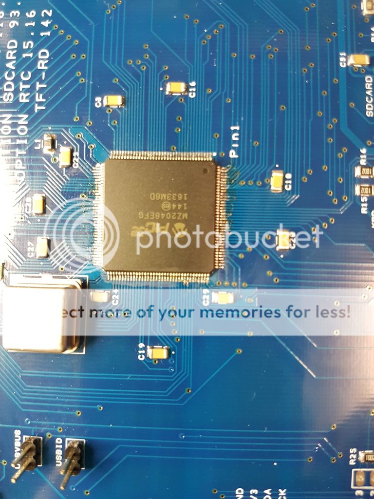

OA47
Joined: 11/04/2012
Posts: 1051
Posted: 06:40am 12 Mar 2018
Here are links (hopefully) to a couple of shots of the board I have loaded:
Full board picture[/URL]
PIC Chip as close as I can get in focus[/URL]
I am sure that I have done something silly and hope it will be blatently obvious to someone else.

Posts: 2991
Posted: 06:59am 12 Mar 2018
@OA47
Just woke up and seen your photos.
My initial observation is that the OSC unit is 180 deg out. I need to go check cos it does look like you have Pin1 in silk screen oriented to your OSC module - but I am 99.9% certain I mount it the other way. Let me go check after I have downed a coffee to wake me up
WW
Posts: 2991
Posted: 07:10am 12 Mar 2018
Yep - Pin1 of the OSC module should be top left IF this is the same design as Peters MMX144 PCB (without any modifications).
Check this thread (scroll down a little) to see the photo of an unpopulated PCB showing Pin1 in top left (i.e. nearest to the 3x 120R VGA resistors).
Swap that around (if an unmodified PCB) and try again
Leads to question - why does silkscreen show different on your PCB?
Posts: 2991
Posted: 07:13am 12 Mar 2018
I see the circuitry around the OSC module IS positioned differently so my two above posts are probably irrelevant. I do not have that design of MMX144 so apologies for mis-information there!
EDIT - I did say that I'd just woken up!!Edited by WhiteWizzard 2018-03-13
Posts: 2991
Posted: 07:19am 12 Mar 2018
Is the green wire on PIC1455 Pin 11 just a 3v3 'check-point'? OR is it linking to Pin8 for some reason?
This shouldn't have an affect (assuming the PIC1455 circuit is different to mine too!). It is just curiosity.

OA47
Joined: 11/04/2012
Posts: 1051
Posted: 07:52am 12 Mar 2018
WW, The boards I have are Version 1.2 not Version 1.1 as your post links to, so I think that would be the difference with the oscillator.
As I hadn't populated the PIC1455 I used the green link to make LED1 a 3V3 power LED.
