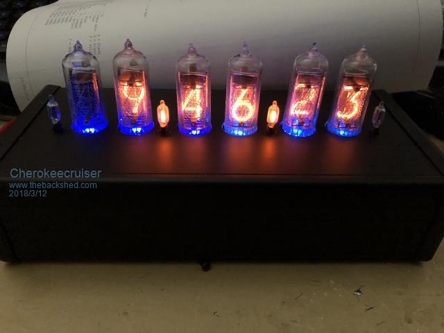

Cherokeecruiser
Joined: 25/02/2015
Posts: 25
Posted: 12:23am 12 Mar 2018
Hi Redrok
I have made about 5 nixie clocks to date - I used this IC
http://tubehobby.com/show_det.php?det=34
K155ID1 High voltage driver IC
The rest of the circuit is pretty much as every one else's on the internet - 555 HV generator etc. (I multiplex the Nixie tubes in 3 groups of 2 with each group selected by a set of MPSA 42 and MPSA 92 HV transistors - but multiplexing is not supposed to be ideal for tube life)
Currently using a PIC16F876 but in the process migrating the code and hardware to MMX
I can give you more details if you want

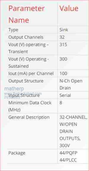

Posts: 11956
Posted: 02:59pm 21 Mar 2018
Have you seen this driver makes life very simple but note 12V logic so needs a level shifting mosfet in the drive from the PIC. I've ordered a couple of samples to play with.

Posts: 11956
Posted: 06:20pm 21 Mar 2018
  Quote  However, it can't operate as a current sink on the cathodes.
Don't understand what you mean, as I understand it that is precisely what it does - what am I missing?
It also allows the brightness to be PWM'd using the BL pin - pulling this low sets all outputs to off irrespective of the state of the latches.
While that chip has open drain outputs that "Sinks" current its not a current sink circuit that controls the value of the current being sunk.
The classic "Current Sink" circuit controls the current.
In my circuit diagram with 1.6K emitter resistors and the bases driven to 3.3V or 0V sinks about 2.7mA of current.
I have changed the values to 2.2K to lower the sink current to about 1.3mA.
I added the standard current sink circuit at the bottom of the Array circuit.

The current will be:
(3.3V - .6V) / 2.2K = 1.3mA or so.
Your circuit controls the current through the Nixie with the 15K anode resistor.
Supply Voltage = 180V
Running Voltage of the Nixie = 140V approximately
(180V - 140V)/15K = 2.7mA
BTW 2.7mA seems a bit high for the IN12A even though 2.7mA
