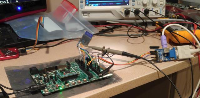

raykj
Joined: 06/03/2018
Posts: 4
Posted: 02:50am 04 Apr 2018
  chronic said   I forgot about the little on-board 16x2 LCD, I was thinking more of Peter's great direct-lcd screens/drivers. They would be a good option, and would save buying the expensive Microchip exp16/32 graphic lcd adapter + module :) Lots of interest there! The MMBasic VGA is a separate console option though, I think (?)
Here is the debug setup with ps2/vga breakout board and sd card socket. Upper left is bottom of the mmbasic editor in the monitor. Yes, had to enable vga in basic since the pins are conserved on initial startup.
