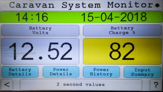

Hi Folks,
Been working on this system for about 4 years now - original was on a Colour Maximite.
link to zip file
There is a detailed explanation together with copies of the programs in the linked .zip file above.
The latest incarnation uses a split system - a data collecting "front end" in the front battery boot and a data display "back end" inside the caravan. It also uses a full GUI display and touch interface.
The back end program will run in simulate mode if COM1 Tx and Rx are looped to one another.
It is still a "work in progress" and I would like to incorporate some of the nice features that other 'shedders' have put up.
panky
PS. Quick peek at one of the user displays.

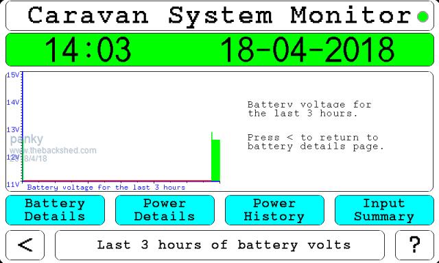

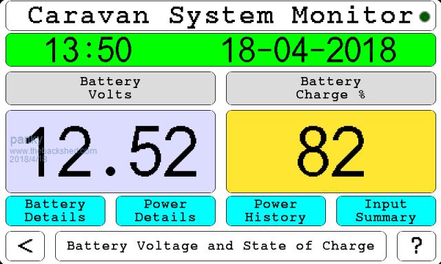

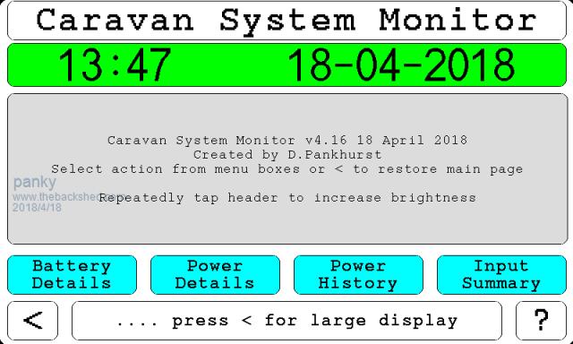

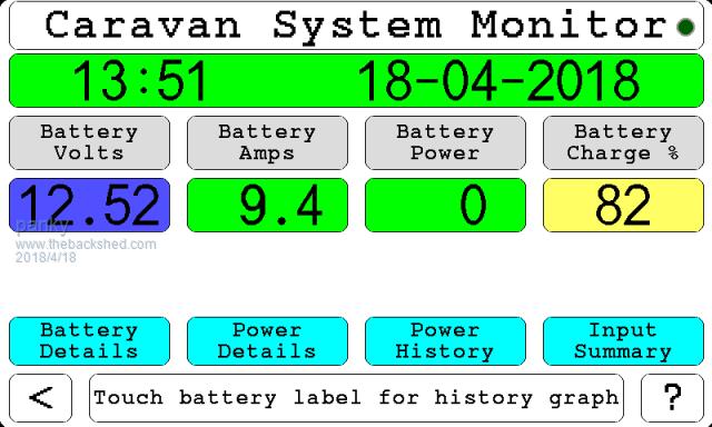

Update:
Fixed a few bugs and got the history graphs working.
The software below will work in simulate mode if COM1 Rx and Tx are looped back.
Had a struggle with integrating GUI displays, touch and plain graphics - I hope the comments are enough to explain the operation. A detailed explanation can be found on Fruit of the Shed here however the software below is the latest and most stable version.
Some screen shots:
Program is as follows:
