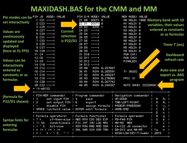

Hi,
MAXIDASH is a dashboard, and an IDE of sorts, for the (colour) maximite. MAXIDASH is an MMBASIC 4 program that runs on the MM to experiment with an MM and to build event-driven programs. You can interactively control pins/ports and enter values and formulas for pins, pretty much like you would enter values and formulas into a spreadsheet. The formulas can be saved and exported to a stand-alone .BAS program.
My design goals for MAXIDASH were:
- I wanted a UI in MMBASIC to immediately give me an overview of pins and connectors and their state, mode and values, to toggle pin modes (restricted to their capability), display pin values or enter their values/formulas;
- I wanted the UI to be interactive, to set pin modes and enter values and formulas while the display is continuously updating (entering formulas requires some tricks to extend the program on the fly );
- the formulas are expressive, including if-then-else (with the C-like ternary operator ? and : pair), conditional operators || and &&, arithmetic, BASIC functions, values of pins and memory cells (Pn, Mn, Dn, An, Cn), timer (T), and key press (KEY);
- fast screen updating, so pin values are read or set at each cycle in a fraction of a second;
- the ability to temporary "hold" values, which suspends updating pin/mem values;
- a feature to save and export pin settings and the pin-updating formulas to .BAS files, to integrate the generated code easily in MMBASIC projects;
Below is an overview of the UI display on a VGA monitor of the current version:
Below are two simple MAXIDASH examples. The first is just a blinking LED (pin0 is switched each second). The second example runs 8 LEDs on D0-D7 as a continuous wave of 4 LEDs lit up. These simple examples should give you a very basic idea how MAXIDASH is programmed as an IDE:

For the second example, the variables M0, M1 and M2 can be interactively changed in MAXIDASH to influence the pattern, or you can create formulas for M0-M2 based on the timer value (t) or a key press (key) value, e.g. M2=key?10*key:m1 will set m1 to the ASCII value times 10 when a key is pressed.
This is free and open source software. The current version 1a is still a bit experimental though I've tested it on a CMM without issues. The export feature currently saves the exported program as a .DSH file since the program itself saves as a .BAS file using the specified file name (ZZZZDASH by default). I'm currently using CHAIN to extend the program with formulas entered, but perhaps LIBRARY LOAD can be used instead to speed this up in the future.
