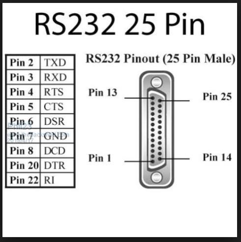

I suspect it's a conventional RS-232 serial interface. That means the serial voltages are up to +- 12V or so.
To be fair there were 25pin Centronics parallel interface connector variants. Notably on the original IBM PC. But I don't think that is what you have, kind of rare.
I used to have a Brother Daisy wheel which has the standard 25 pin serial interface. It used standard ASCII protocol, and not the IBM EBDIC serial.

I'd take a stab at it being serial as well.
Is the interface a 25 Pin D connector?
If so, look at the voltages on Pins 2 & 3 with respect to ground, (Pin 7).
Depending on which pin has the -12V? (or is it +12 idle), Pin 2 or 3 will indicate if it's a DTE or DCE calss device. Basically the two transmit & receive on opposite pins.

Thank you all ! At this stage it looks most like the full rs232,
so I'll check that direction. It's a long time since I saw full RTS/CTS etc.

  chronic said   Thank you all ! At this stage it looks most like the full rs232,
So now the fun begins!
Out with the break box with the LEDs, DIP switches & jumpers, try & work out how the Hell DTR/DSR & CTS/RTS need to be wired on this occasion...
Xon/Xoff.... Might be luck & be able to use that in a very few cases...
Phil.
