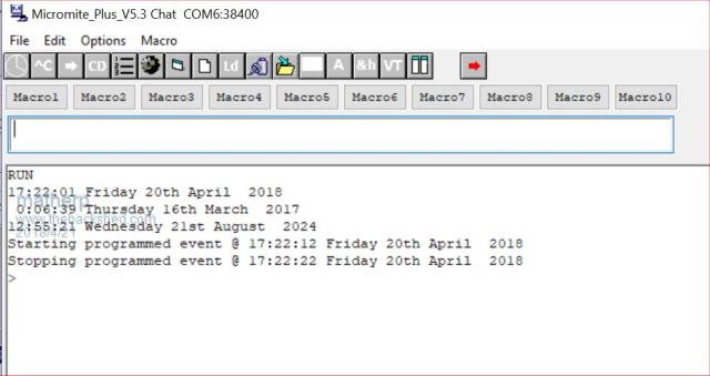

This code implements the full Unix epoch time in MMBasic.
Simply this is the number of seconds since since January 1, 1970 (midnight UTC/GMT), not counting leap seconds.
Having calculated this it is then easy to do time arithmetic without worrying about day rollovers etc.
By-products of the calculations are the day of the week and the day of the year
The demo program shows how simple it is to calculate times in the past and into the future and how to test for events a certain number of seconds from now

print format_time$()," ",daysofweek$(my_dayno), my_day,th$(my_day-1), " ", monthsinyear$(my_month-1) , " ",my_year
' what was the time and date 400 days, 17 hours, 15 minutes and 22 seconds ago?
gmtime(my_timestamp-(400*SECS_DAY + 17*SECS_HOUR + 15*SECS_MIN + 22))
' what will be the time and date 200,000,000 seconds in the future?
gmtime(my_timestamp+200000000)
convert_time()
nowtime=my_timestamp
do
convert_time()
loop until my_timestamp>=nowtime+10
print "Starting programmed event @ ",format_time$()," ",daysofweek$(my_dayno), my_day,th$(my_day-1), " ", monthsinyear$(my_month-1) , " ",my_year
do
convert_time()
loop until my_timestamp>=nowtime+20
print "Stopping programmed event @ ",format_time$()," ",daysofweek$(my_dayno), my_day,th$(my_day-1), " ", monthsinyear$(my_month-1) , " ",my_year
