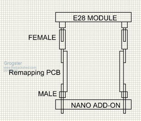

The issue I see with this, is that weather you had the extra row of pins on the inside or the outside of the E28, the footprint would still be wrong for the Nano add-on boards then. Perhaps I am missing something?
Because the E28 is designed to be the same size as a Nano, there is no room to move either side.
Perhaps you could do this with narrow little PCB's where you had female strips at the top, and male strips at the bottom, and the remapping on the little PCB's.
Like this:
That would stand tall though, and personally, I think it would look a little ugly.

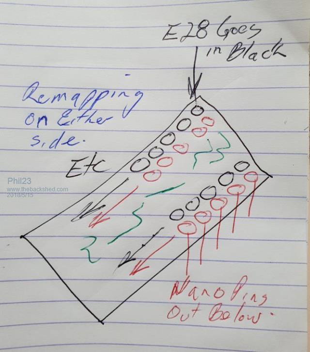

  Grogster said   The issue I see with this, is that weather you had the extra row of pins on the inside or the outside of the E28, the footprint would still be wrong for the Nano add-on boards then. Perhaps I am missing something?
It would need to be at least 0.1" or so wider.
So it was a single board that sat underneath the E28.
E28 sits on top, the 2 rows of Nano pins stick out the bottom, both to say the right of the E28 row.
Remapping on double sided PCB should be doable.
My CAD representation....
It could use pins & sockets, or just joined with pins like Rob's Nano ASCII programmer, which would ne neat, but jut a bit wider in overall width.
Phil.
Posts: 10056
Posted: 10:28am 15 May 2018
Oh, I see what you are getting at.
How would you map the E28 pins to the Nano?
IE: Which pins on the E28, would you want going to where on the Nano?

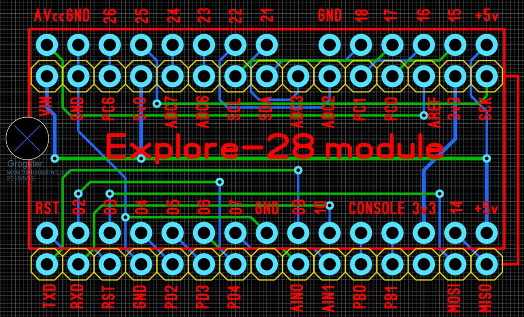

This is what I have so far:
Not all of the Nano pins can be mapped to the E28, but I HAVE mapped the SPI port, the I2C port, COM2 and the console. Pins marked as ADC are MM ADC pins. Pins marked as PB/PC etc are just standard I/O pins. I will make up a proper pin map spreadsheet chart thing once you are happy with what we have.
Phil23
Joined: 27/03/2016
Posts: 1667
Posted: 12:42am 19 May 2018
I think I noticed that you might come up a couple of pins short.
First thought I had was skipping the high number in A0 to ... & D0 to ....
But then thought some of those high number might have other significance, like SPI Coms etc.
I'm sure you thought the same.
Phil.
Posts: 10056
Posted: 12:44am 19 May 2018
Is this the sort of thing you are after though?
Can you see any obvious changes you would like made?

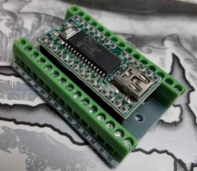

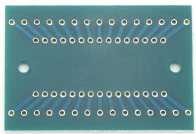

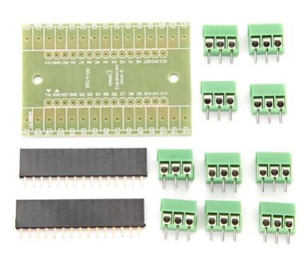

I was looking for parts on www.banggood.com to see if prices had changed on a few
items I got last year. I found this that may be of use to E28 users. And remembered
this post.
I had picked up a few of ones like these but thay had the Ground pads tied where
these are nicely just raw point to point.
A fast way to make use of an E28.
