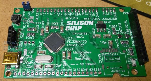

I seem to recall that Silicon Chip did a MicroMite Plus Backpack. It might have been a Geoff design, or a Peter(matherp) design, but I can't remember. That gives the MM+ feature-set, along with a graphic LCD. I think it still used an SPI LCD. I will have a hunt through my SC issues to see if I can find where it was published.
SteveA
Joined: 10/03/2017
Posts: 49
Posted: 11:02am 30 Apr 2018
  Quote  I seem to recall that Silicon Chip did a MicroMite Plus Backpack
'The Micromite Plus LCD BackPack' - November 2016 page 64 - 73
I've built two of them, they work well. The only small difficulty is soldering the smd PIC and USB socket.
The LCD/touchscreen plugs into the raised headers on the left and right. Any additional electronics you need can be mounted underneath, the processor pins are brought out to the top and bottom rows of pins.
Note that the touchscreen has a SD card socket, so I don't use CON9 on the pcb.
Here in the UK, I think EPE also did a series of articles about it.Edited by SteveA 2018-05-01

SteveA
Joined: 10/03/2017
Posts: 49
Posted: 11:32am 30 Apr 2018
  Quote  I had much fun trying to get mine to go properly, particularly the USB connection because my USB PC supplies were bit below par & couldn't handle the LCD backlight above about 10%.
I had that problem too. I found using a short USB lead with thick copper cores helped, I think it was voltage drop caused by resistance in the cable.

  SteveA said   The only small difficulty is soldering the smd PIC and USB socket.
Totally agree with that, SteveA.
Can you elaborate on how you mount extra stuff? I've got mine socketted onto a big bit of a strip board ATM (with power supply) for testing etc until I decide what to do with it. Be room underneath for some stuff as you mentioned.
ChopperP

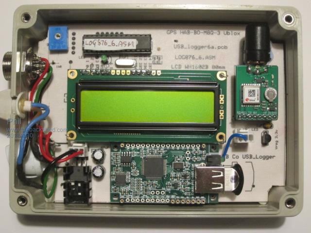

Phil.
Joined: 20/11/2017
Posts: 9
Posted: 12:34pm 30 Apr 2018
Thanks chaps. Looks a big lump with capabilities I don't need. And lots of assembly to do, and comes without TFT that must be sourced separately. But might be the best option. If our rotten weather continues I might have plenty of spare time.
Attached might be an image of my last effort which used a PIC32 USB storage module. All the hard work done for me though the file formatting was unusual!

  Quote  Can you elaborate on how you mount extra stuff?
I tend to breadboard new ideas, then once I'm happy with them I transfer them to stripboard or sometimes homemade pcbs. So I end up with a stack of 3, lcd on top, micromite in the middle, my circuit on the bottom.
I interconnect the boards using pcb headerstrips and pins, just like the ones the lcd connection uses.
The boards are held together with long screws and nuts, it makes for a cheap and remarkably robust solution.

Hi chronic, Andrew. Yes you got it Andrew. I chug around in my boat with the depth sounder over the back and record serial sentences fron both GPS and the depth sounder, combine them in a single sentence and save to micro SD card. Later, on a PC I can calculate tide height from the time and subtract depth. This gives mud height over datum. Then plot a screen with coloured blobs for different depths and join the dots in a paint program. Sort of automated manual process. Works well enough.
I surveyed a troublesome area last week and confirmed it hadn't changed much but was still troublesome. We went away for a long weekend and came back passing a fellow club member stuck fast on the sandbank I had been surveying. He lifted off on the tide later but it looks as if my services are still needed!
I skipped a few refinements in the above discussion but you get the picture. I will post the result when I have it but it is getting off topic by quite a long way! All the best, Phil.
