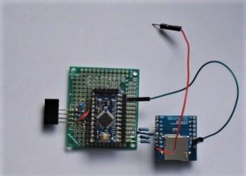

This is the semi-prototype, using a "pro mini" (approx 4$), and
a sd micro socket.
The four connections at at the left are used like miso, mosi, clk, ss.
(I am using pic port B0, B1, B2, B3 just as ordinary port B i/o,
it is arbitrary)
There are 5v-3.3v dropping resistor dividers, and the leads are
3.3v and ground. (ed - also two more for 5v/0 for the mini)
To use it with other systems, some routines are needed eg
OPEN, READ, WRITE, CLOSE
which just send constructed 16 bit words exchanged as per spi.
It will be more useful with filename selection, which is in
final progress, hopefully something like
OPEN 'filename.csv'
OPEN 'filename.csv' WRITE
etc.
ed - PS I used one of Mik's protoboards - excellent thanks Mik
Edited by chronic 2018-05-28
