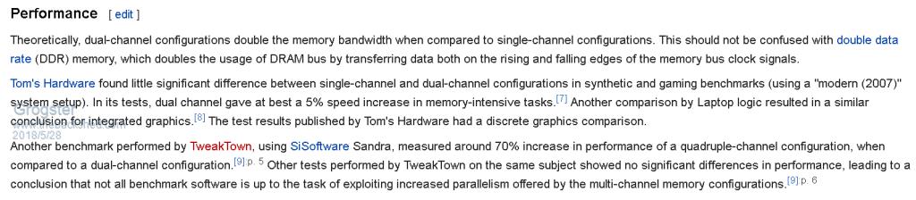

If I have a system with one 8GB RAM stick, is there any benefit in going to dual-channel RAM? IE: 2x 4GB matched pair so I can run the memory in dual-channel mode.
At the moment, my machine has a single 8GB stick, in one slot. 8GB is the maximum supported system memory. The board does support 'Dual-channel memory architecture'. As I am thinking about doing a rebuild of this machine, I was thinking it might benefit the speed if I was to swap the single 8GB stick, for two 4GB sticks. I expect you end up with the same 8GB total, but that RAM access should be twice as fast(in theory), providing a useful boost to general performance.
Yes? No?
I've never really run anything in dual-channel memory mode before, so I am not sure if I am actually thinking correctly or not.
EDIT: I have done a little research on this, and as usual, theory and practice are two different things.
Quad-channel memory would seem to result in noticeable speed increases, but not dual-channel, based on that. I think I will just stick with a single 8GB stick. It's not worth the extra expense of a matched pair, if I don't stand to gain something significant from it.
Still interested in any other comments from members on this issue.Edited by Grogster 2018-05-29

Hi Grogs
I've never noticed any worthwhile speed difference (make that ANY difference) from using single or dual channel RAM.
Of course as with anything - YMMV - it depends on what test you use & with what hardware. As far as the real world goes I really don't bother these days

Sounds good to me. Case closed.
Anyone else who wants to comment, feel free, but I expect that dual-channel is just not worth it on modern hardware. Might have been useful with older, slower hardware. A modern machine with quad-channel memory looks to be a different issue, but I am only concerned with dual-channel here.
