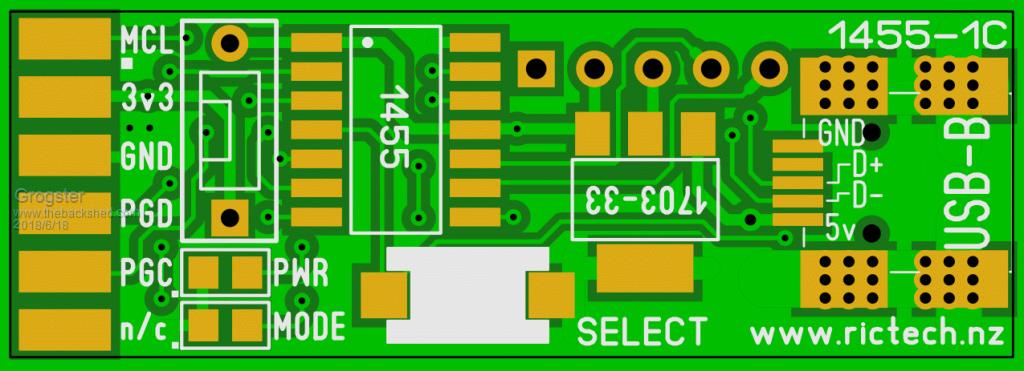

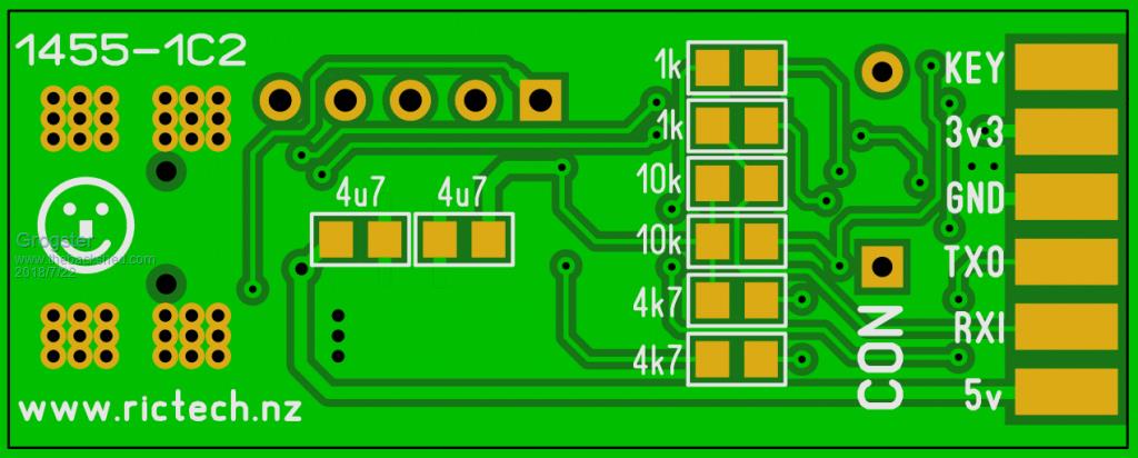

As a follow-on from the thread about the 1A, here is the latest version:
Still a work in progress, but SOIC 1455, DIL switch for 3v3 on/off, 0805 passives, SOT-223 regulator and USB-B socket. ICSP standard pinout on one side of the unit, and console connection on the other. Still fine-tuning the layout, but this is the new design.

I think I am missing something re the 3v3, 5v no power options.
I understand the chip is only programmed at 3v3, but if you are running the board using the comms side would you not want the option to power the target board (probably with its own onboard 5v to 3v3 regulator). If it is fed through the 5v from the USB there should be enough to even power an onboard LCD on the target.
Like I said I am probably missing something, but I see that as very useful especially for initial configuration and testing of the taregt using the serial comms after the chip is programmed.
Posts: 10056
Posted: 10:10pm 18 Jun 2018
In that event, switch OFF the 3v3 DIL switch, and use the 5v supply on the console side of the PCB. Done.

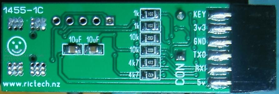

Posts: 10056
Posted: 10:04am 21 Jul 2018

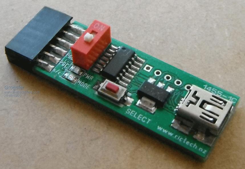

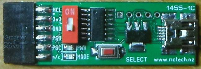

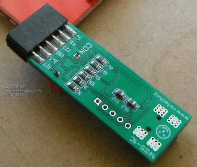

I have finally managed to build this. It works, and Windoze sees it fine as per all 1455 chips.

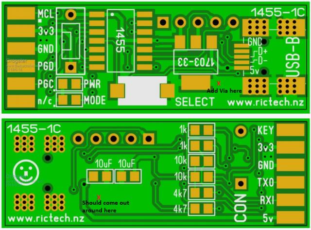

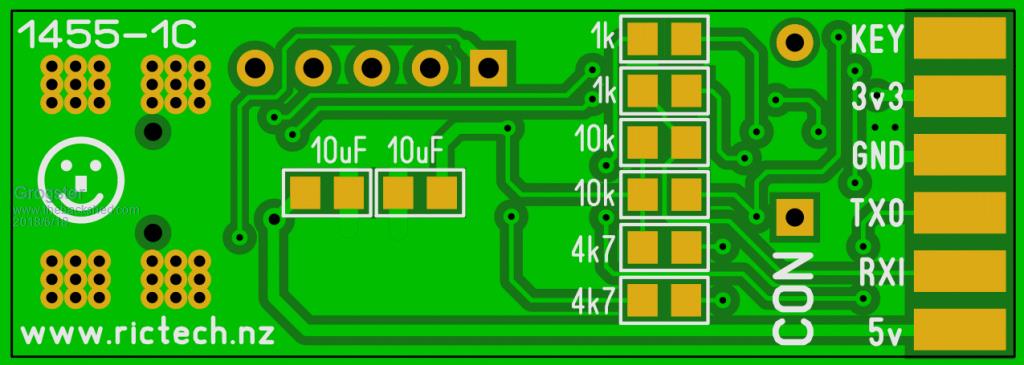

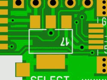

hmmm, there may be a slight problem. the ground connection for the two 10uF filter capacitors (that should be 4.7uf to keep within the USB specs, btw) seems to be entirely through a sliver of ground fill. you may wish to add an offcut of resistor lead from the junction of the two capacitors to the cluster of vias just above the word "rictech".
rob :-)
Posts: 10056
Posted: 03:00am 22 Jul 2018
Well spotted! I will alter that to give more copper ground plane for the caps, and change the silkscreen to 4u7.
Posts: 2552
Posted: 04:43am 22 Jul 2018
you may be able to just add a ground via:
the other side should come out close to the junction of the caps.
rob :-)

Posted: 06:03am 22 Jul 2018
Or another possible solution requiring less adjustment to the board layout - add a via to the right of the 1703 regulator tab as shown below. This should connect to the ground copper below the capacitor closest to the USB connector, approximate position as also shown below.
Phil.

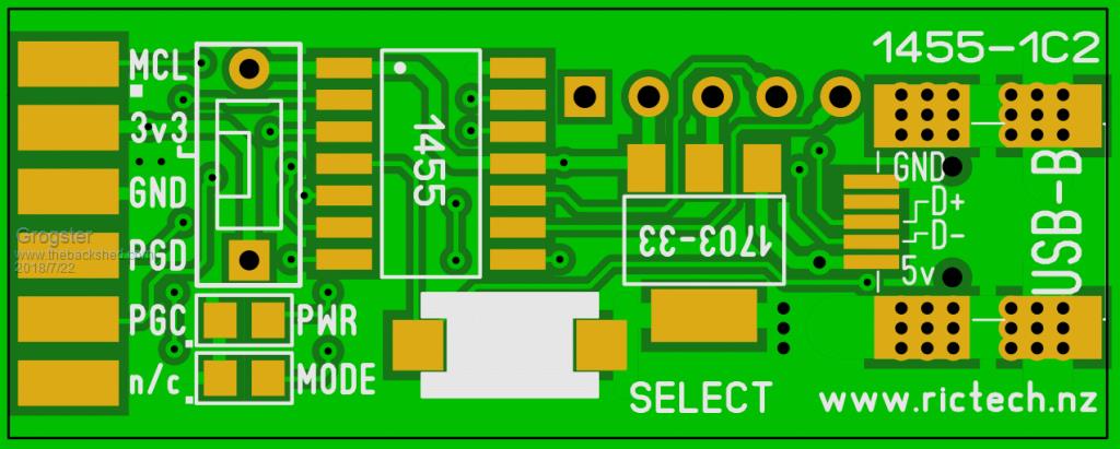

Posts: 10056
Posted: 06:46am 22 Jul 2018
All of these suggestions have been taken on board(pun!), and this is what we now have:

Posted: 12:02pm 22 Jul 2018
Grogs, would it be worthwile adding through-holes on each of the ICSP tabs to optionally allow 'normal' headers to be used. That would allow it to be used flat on a breadboard, single or double pin-wise - or any other orientation people might want.

  paceman said   Grogs, would it be worthwile adding through-holes on each of the ICSP tabs to optionally allow 'normal' headers to be used. That would allow it to be used flat on a breadboard, single or double pin-wise - or any other orientation people might want.
Greg
Not sure how that would be done given they are at the same place on the PCB on opposite sides.
Posts: 10056
Posted: 11:04pm 22 Jul 2018
@ Azure and paceman: Can't be done, as Azure says, due to the pads on the other side. Mounting to a breadboard is as easy as just plugging it into some long pin-strips - problem solved. You could even use right-angled pin-strips if you wanted it laying flat - sticking up problem solved.
