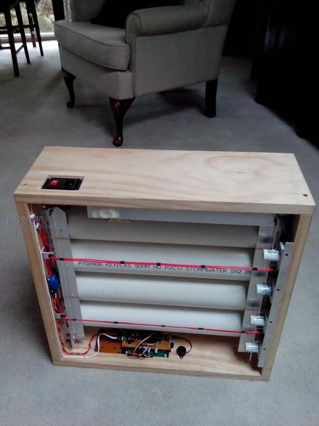

Hi Andrew - I've got a reasonably fancy one I built three or four years ago from a USA design and I'm not using it currently. It's about 500mm square, 240v, MM based auto-timer/controller with 20x4 LCD display and four proper UV tubes with "paralled" reflectors - probably just what you're looking for. If you're just East of Melbourne then I'm not far from you, I'm at Research just outside Eltham. Send me a PM so that I can call you.

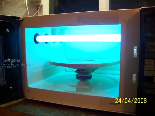

This was my home-made one I used for years, built out of an old microwave oven:
I still use it to UV test things to find out if they break down. A few hours on high.....

  Quote  This was my home-made one I used for years, built out of an old microwave oven:
Now that's something to like!
Is that a speaker cone instead of a turntable?
Posts: 10056
Posted: 05:57am 31 Jul 2018
Yes, I used an old 8" speaker as a chassis thing for elevating the new wooden turntable up closer to the UV tubes. It is connected to the turntable motor, and turns the boards in the UV light just as it used to do when cooking food. This project was published in Silicon Chip magazine about ten years ago or so. It even featured on the cover, which was a nice surprise for me when I got that issue!

Just don't pay TOO much attention to the extreme criticism in the following months, to the point that some readers said that SC should not have published it at all.
I used earth wire as a live conductor. It was marked and labelled, and I was the only one to ever work on the unit, but that made some readers loose their balls over it. Probably about November or December that year from what I remember.
They WERE right. I should not have done it like that, but I had already wired the bloody thing up before I asked SC if they were interested, and when they said they were, I could not be bothered to rewire it. I suppose I should have.
Technically, the criticisms WERE correct, and it was something I should not have done in hindsight. I would never use earth wire as a live conductor ever again, so they did make their point I suppose.

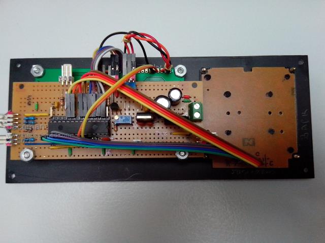

Anyway, Andrew_G came around today and he now has the unit I built back in mid 2014 using 90mm split pipe lined with aluminium adhesive tape for reflectors, UV tubes and a MMX150 uMite controller (MMBasic V4.5) with a 4x4 keypad and 4x20 LCD display. Some pictures for everyone below just for fun. I was going to write this up properly for TBS but the cheap and good stuff that came out of China about the same time made it seem a bit pointless.
