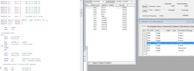

I used MPLAB 8.92 to write & test a .asm programme for the 16F1708 PIC.
I chose that PIC as it has Interrupt on Change on all inputs.
I have found that IOC only works on PORTA inputs.
When I change one of the PORTC inputs, the IOCCF flag does not change & the PIC won't exit Sleep - as it does for PORTA inputs.
Is this due to a fault in the MPLAB software, or am I missing something?
Any assistance will be appreciated.

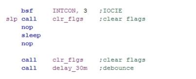

  Azure said   OK, you should have mentioned in your first post that you are trying to wake from sleep and are not using interrupts. Sorry, I did not think of that since the PIC will awake from sleep without setting GIE.
You listed code does not set INTLVC so port C will default to ST mode. Someone on another forum mentioned this yesterday so I added INTLVC. I want it in the ST mode
You should also make sure to clear IOCAF and IOCCF before going to sleep.I clear them after exiting from sleep
If that does not work make sure you can read the IOCCF flag bits changing for each appropriate port C pin during normal operation (not in SLEEP).

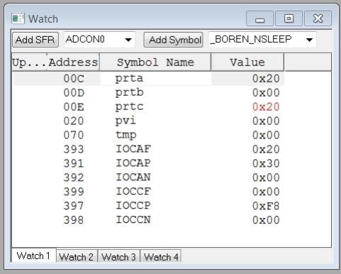

The IOCCF never changes at any stage as you can see in the attachment.
I have to change PORTA to exit from sleep.
I'll programme it into a PIC & see if it works. If so, that will prove my presumption that the MBLAB software is faulty.

Sorry I cannot read the text in the images they are too blurry.
You need to make sure the interrupt flags are cleared before you go to sleep, otherwise they will not sense a change and trigger the wake up.
I think you misunderstood my last point. As part of troubleshooting the problem you need to:
Make sure the connections to port C can be read and match the input on them;
Test them in both off and on states.
To do this you need to write some test code to make sure you can read port C pins while it is not asleep and see that input low and high signals are being read correctly. This is for testing your connections and setup of port C it would not be part of your normal code.

I think I did understand your last point but you may a missed my point. The point I was trying to make is that the IOCCF is always 0 regardless of whether PORTC is changed in sleep or out of sleep. Whereas, the IOCAF changes as expected.
That's why I think it is a MPLAB software fault. I read somewhere that MPLAB 8.92 does not fully support this PIC.
See the attachments.

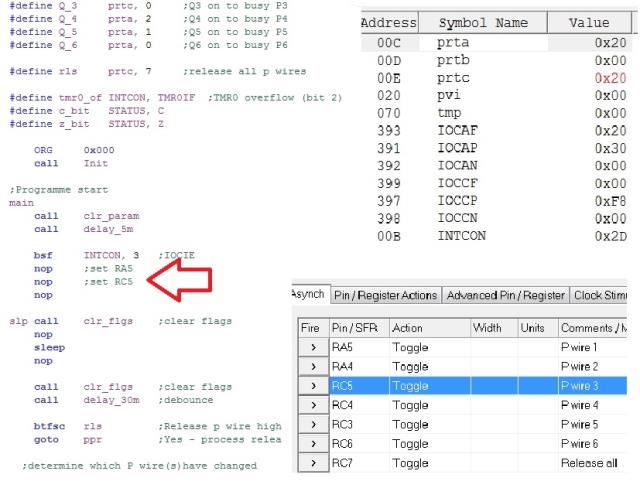

I did as you suggested in your last point. I inserted some nop statements. I changed PORTA at the first nop & PORTC at the second. The attachment shows the result. IOCAF changed, but not IOCCF.
I made them larger, so I hope you can read it this time.
Azure
Joined: 09/11/2017
Posts: 446
Posted: 07:25am 20 Aug 2018
Are you doing this only as a software simulation or working with a real chip?
For the purpose of testing port C function you should not change any pin on Port A and just change a pin on port C to test it.
How are you clearing the flags?

  Azure said   Are you doing this only as a software simulation or working with a real chip?
I'm simulating with MPLAB.
I did that - no difference. IOCCF Is still 0x00.
Here is the sub routine that clears the flags.

  Quote  I'm simulating with MPLAB.
IMHO you are expecting far too much of simulation. You have to test on the silicon to see if there is an issue.Edited by matherp 2018-08-21
