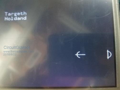

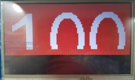

I have a 7" SSD1963 LCD display connected to the Peter Mather Backpack+.
MicroMite+ code I've tried: V5.04.10_Beta, V5.04.09, and V5.04.08.
If I OPTION LCDPANEL SSD1963_7, LANDSCAPE or OPTION LCDPANEL SSD1963_7A, LANDSCAPE and then write to the screen, everything is fine.
If I then OPTION TOUCH 51,33, 50 the screen only displays about 3/4 of what I expect it to display when I write to it.
Anyone see this before? Is anyone set up to reproduce it?

Posts: 3368
Posted: 11:57pm 21 Aug 2018
All my tests with the current beta versions have not shown this.
From the image it looks as if the SSD1963 scrolling register is set to a non zero value. This register is set to zero when the LCD is powdered up and is only changed by MMBasic when OPTION LCDPANEL CONSOLE is used and the display needs scrolling.
I don't have any clue as to how it got changed in your case (if indeed this is the issue). The OPTION TOUCH command has nothing to do with the SSD1963 chip.

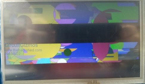

Thanks, Geoff. It is consistent about working right graphically until the OPTION TOUCH happens.
The GUI TEST LCDPANEL does this:
Note the circles are cut up.

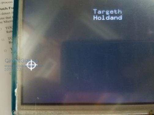

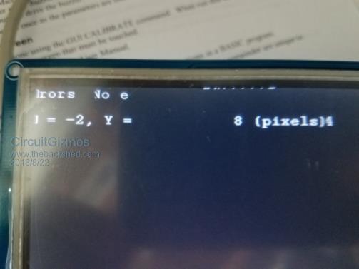

GUI CALIBRATE does this:

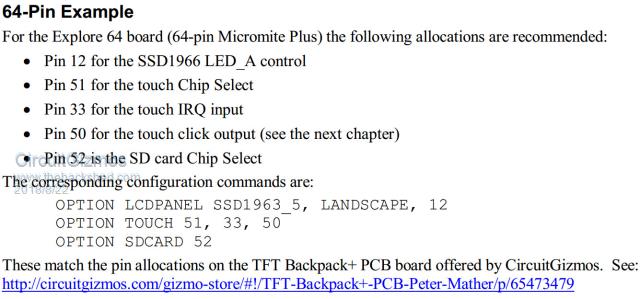

Panky: The options that I followed were from the MM+ manual. I tried your OPTION commands above but it made no difference.
OPTION TOUCH 51,33, 50 in the MM+ manual doesn't seem to be right for the PM Backpack+. Your 42 makes sense.

The pins in the MM+ manual are for the Explore 64 which is different to Peter's Backpack.

I think I have it - pin 50 on Peter's board is SPICLK so as soon as you setup your TOUCH options using 50 as your click pin, you screw up the spi clock.
panky

These do NOT match the Backpack+. Manual should be changed.

CircuitGizmos
Joined: 08/09/2011
Posts: 1427
Posted: 01:23am 22 Aug 2018
Well!
Ah HA!
If in doubt, blame hardware.
There was a very fine strand of something conductive laying against the processor pins. I pulled it off, and then put the localized hot air tool to the pins.
All is good, now. Fire is out!
Thank you all for your help.
