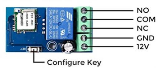

I was sent one of these with a 2 relay module order. They didn't want it back.
So I looked it up and found an app for the phone.
This one wanted my wifi SSID the newtwork password. I may be wrong but it
seemed to me this information was going out the app and over the internet
before reaching the device. Now if it was to the device only that would be fine.

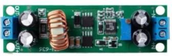

I have been trying to get the serial port data of the controller. It's 9600 baud
but the information I need is what I send to it to turn on pas and a few other
features. Also it can give me the Voltage/Current and I think speed.
The battery I have is 48V 20AH Lifepo4 Rechargeable Battery Pack with BMS.
I am using two down converters one for 12volts the other 5volts.
Needed these they take up to 60Volts input. Fully charged battery is 58.4Volts.
