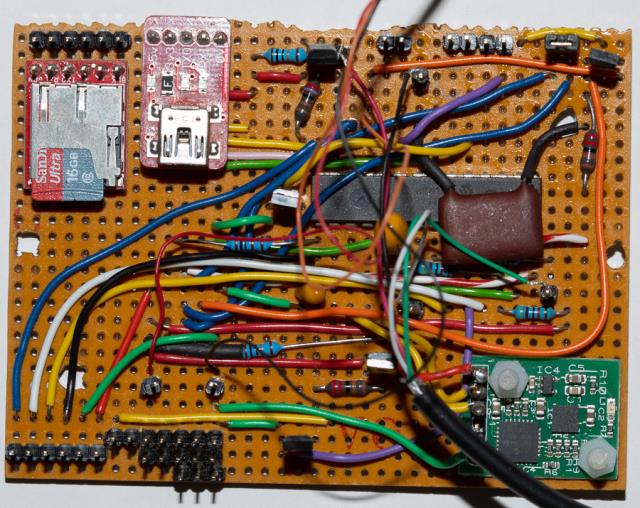

A veroboard which normally works fine has developed a habit of sometimes working ok and sometimes going into a loop in which the MM interpreter repeatedly restarts itself, printing:
Micromite MKII MMBasic Ver 5.03.02
Copyright 2011-2017 Geoff Graham
repeatedly. It can be stopped by hitting contol-C, but the looping resumes after RUN.
It has correct 47uF decoupling capacitor. The restart line, pin 1, is wired to V+ via a 10K resistor and is otherwise not connected to anything. V+ is 3.3 volts. The program is not executing any END command.
Any ideas what could be causing this?

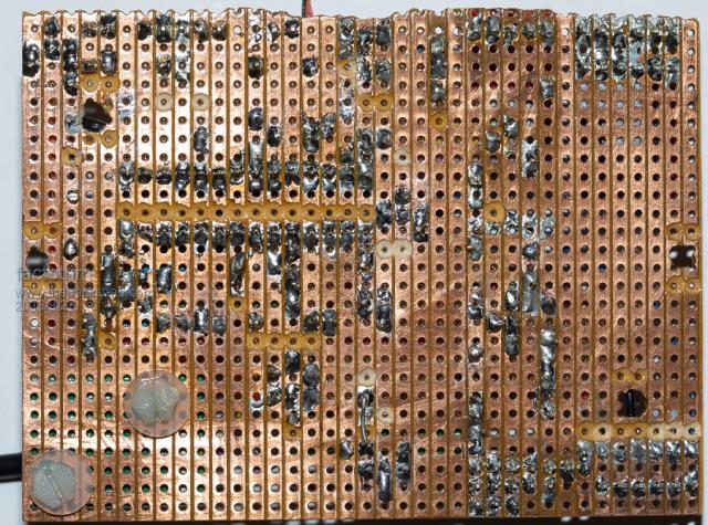

factotum
Joined: 29/10/2017
Posts: 18
Posted: 05:13pm 26 Sep 2018
WhiteWizzard - Yes, well when I designed this layout it was fairly clean and logical, but I have had to make so many addons and mods over the past year that it is now a right mess! That might be the cause in fact.
These photos are missing the 10K resistor to pin 1 as I just decided to replace it and resolder. Board is covered in a conformal coating (it goes in a model boat in an IP68 box), which I have to scrape off every time I change anything.
Decoupler is tantalum. The Vreg is built into the USB-to-serial converter seen to the right of the microSD card. I power this from USB when testing but from lithium power pack when sailing. This 3v3 only feeds the MM. Lots of stuff on MM: serial line from GPS unit, I2C from compass/gyros, SPI from shaft encoder, A-to-D from power voltage, other pins sensing digital data or pulse length (from anemometer), the SD logger hanging on console output, as is a LoRa transmitter (via a fet switch).
Probably not much you can say other than "It's a mess, what do you expect?"!
Posts: 2991
Posted: 07:23pm 26 Sep 2018
OK - I initially thought it was because you were drawing too much power from the 3v3 output on the USB-to-UART module - however, you say that you're only powering the MM from this 3v3 rail.
Note: The 3v3 output is good for about 50mA; any more and you will starting causing power glitches (resulting in the MM resetting).
In your original post, I mis-understood your comment 'otherwise not connected to anything'. I incorrectly assumed the MM was not connected to anything other than the 'basic' circuit (i.e. 10K resistor and 10uF vCap). Seeing the photo has helped (sort of!) in highlighting the potential issue:
IF it is only resetting 'sometimes' - is it when your program is running? If so, you could have a logic-level conflict occur somewhere in your code i.e. you set a pin to a low output when at some stage the pin becomes a high level.
Prevent your code from running (possibly need to turn AUTORUN OFF to help) and leave the MM effectively at the Command Prompt. Type EDIT, then hit ESC (to exit EDITor) and this will 'reset all I/O pins. Then simply leave everything as long as possible and see if the MM resets itself. If it does, then it is likely a power issue. IF however it doesn't reset, then it is likely a coding issue (level-conflict).
Hope the above kind of makes sense; and more importantly helps you diagnose the issue . . .

panky
Joined: 02/10/2012
Posts: 1135
Posted: 01:04am 27 Sep 2018
@factotem,
With respect, there are some pretty dodgy looking joins on your veroboard, I would start as a minimum, re-soldering all the MM pins and then inspecting them under a magnifying glass.
If flexing the board is causes the problem then this just highlights my suggestions above.
By the way, bin where you are myself and it can be frustrating - stick with it and I am sure you will get it going.
panky.
Azure
Joined: 09/11/2017
Posts: 446
Posted: 03:25am 27 Sep 2018
Nice project.
I agree with Panky. I would resolder the MM pins for a start.
I would also resolder the joints from the power source(s) to the MM chip and consider adding a bypass cap on the 3.3v as close to the MM as you can. As you have expanded the circuit over time any noise and intermittent power used from the peripherals may be causing a voltage dip at the power pins on the MM.
Check what conformal coating you are using, some are able to be soldered through so you don't need to scrape it away to do any mods/changes. Also some have a remover that you can spray it with and give it a brushing/wash to remove the coating before working on it.
If you have to remove it make sure you also give it a good scrub with PCB cleaner or isopropyl before soldering to clean up the joints and make for easier soldering.
Use a good flux based solder and even dab the points to solder with a flux pen to make the solder flow nicely. Afterwards clean any flux residue with PCB cleaner or isopropyl (which it looks you have been doing) before touching up or reapplying the conformal coating.
Good luck with it, with a little patience you will track down the cause, keep us posted or ask more questions.

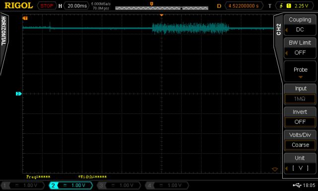

Joined: 29/10/2017
Posts: 18
Posted: 12:13pm 28 Sep 2018
WhiteWizzard - Good thought. I couldn't see a short. Looking at pin 1 on a scope did not seem to show anything awry:
But I did have two blue wires going to a jumper top right on the board, and they ran parallel to the 10k resistor on pin 1, and they carried console transmitted data. I decided to move the jumper elsewhere and get rid of those blue wires. And the problem has gone away. No more tap or flex sensitivity. No more restarting.
Still not totally sure of the cause. But happy it's no longer there.
Thanks to all.

factotum
Joined: 29/10/2017
Posts: 18
Posted: 05:23pm 28 Sep 2018
Finally managed to get a scope on it when it was reliably looping. Pins 13 and 1 ok, but pin 28 (analog V+) had about 1.4 volts of noise on it. This enabled me to find a dry joint between pin 28 and the 3v3 power. Not totally clear why noise on the analog power should affect digital operation of the MM, but it seems it did.
I think it is ok now, but not going to claim that until more testing, in view of false alarm earlier.
