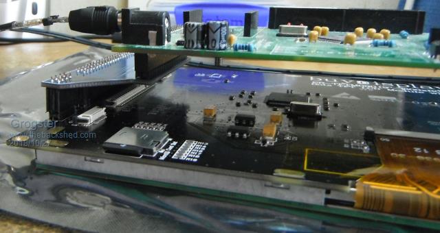

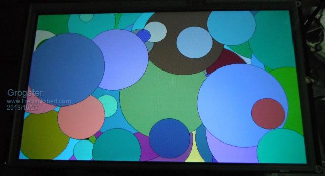

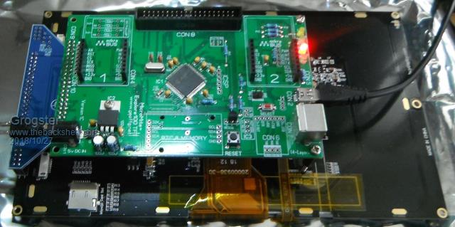

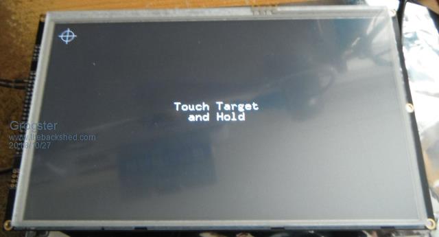

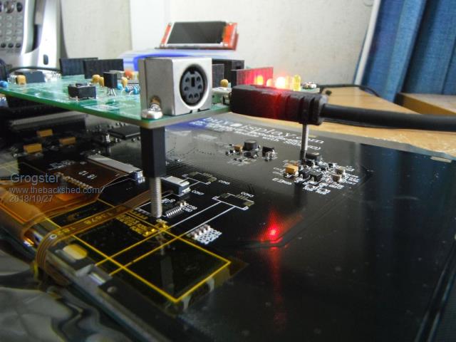

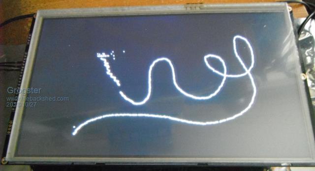

Hello.
I thought I would start a new thread for the adaptor board being talked about in the other thread, now that I have one working.
All functions work. LCD(naturally), touch and SD card have all been tested and work fine. The adaptor board is setup for 16-bit parallel bus to the 1963, but the E100 only uses 8-bit mode. The point being that you SHOULD be able to use this adaptor on matherp's MMx and the ARMmite which I think use a 16-bit parallel LCD bus.
I might have to get a few more of these 9" LCD's....

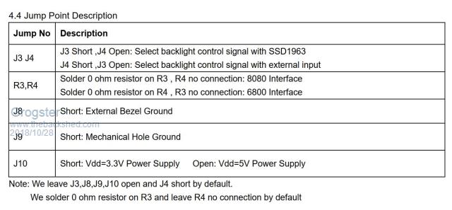

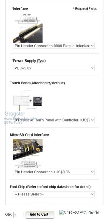

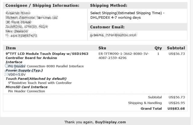

  Zonker said   Nice..!! Where can the display be had..?? I want to be sure to get the correct one... Thanks G..!!
You have a choice of 7", 8" or 9". They can all be had from BuyDisplay, but the 9" one I got was from this link.
Be sure to select the correct options:
- Pin Header 8080 interface
- Power Supply 5v
- 9" touch panel with controller
- Pin Header micro SD card interface
- No font chip (just leave it saying ---PLEASE SELECT---)
As they are a big TFT, the freight is reasonably expensive, but you could make them much more affordable if you were to buy more then one, then you would still only pay one DHL cost.

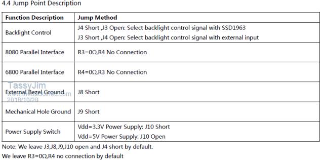

Once you get the display, be sure to remove the solder-blob from J4, and put it on J3(leaving J4 open), so that the display will work with SSD1963 backlight control. They come preset for 8080 interface as ordered, so you don't need to change blobs R3 and R4. But the backlight blob had me scratching my head in the other thread, as I forgot to set it, then the display was just blank.
Posts: 6632
Posted: 01:24am 28 Oct 2018
That has me confused.
Mine came with J4 shorted and J3 open. According to the manual, this is correct for SSD1963 backlight control.
Haven't fired it up yet.
Time will tell and I am glad that it's an easy blob instead of a pesky resistor.
Posts: 10076
Posted: 03:15am 28 Oct 2018

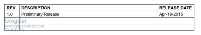

Interesting. My PDF says the exact opposite!
Note how my PDF says J3 short, J4 open for 1963 backlight.....
What I can confirm, is that I have J3 short, and J4 open, and it works.
J4 was short when I got the display. Typo in the manual, I expect, one that they appear to have corrected.
Posts: 6632
Posted: 03:28am 28 Oct 2018
Oh good!
It would be boring to have a consistent source of information.
My datasheet came from buydisplay.com and is Rev 1.0 dated Jun 18, 2015
Posts: 10076
Posted: 06:18am 28 Oct 2018
Mine is ALSO version 1.0, but dated Apr-18 2015.
Technically, YOUR manual is the more up to date one!

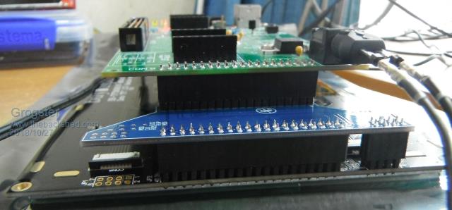

Thanks Groster, the little board arrived very late today, I just soldered it up and tested it with the one ARMmite wired in 8 bit mode - perfect. I'll have to grab my other ARMmite and test in 16 bit as it's wired for 16 Bit, great work.
Mike.
Posts: 10076
Posted: 09:51am 05 Nov 2018
Fab. Thanks for letting me(and the forums) know.
KeepIS
Joined: 13/10/2014
Posts: 2287
Posted: 01:10am 08 Nov 2018
Confirmed the Adaptor board works perfectly with the ARMmite-H7 plus backpack PCB (daughter board) in both 8 bit and 16 bit wired modes.

Also confirm the adapter board works with 9" panel with the ARMmite-H7 plus backpack PCB +AFTER+ I removed solder blob on J4 and added one on J3. GUI CALIBRATE works, my screen displays, BACKLIGHT nn works.
But--everything is tinted light blue. Text which displays white on a 7" panel is light blue, and background which should be green is blue. Any ideas as to why that might be?
CLS RGB(YELLOW) is aquamarine
CLS RGB(RED) is light green
CLS RGB(BLUE) is blue
CLS RGB(WHITE) is aquamarine (slightly lighter than CLS RGB(YELLOW))
