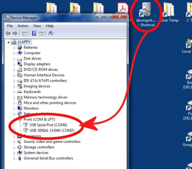

CaptainBoing
Joined: 07/09/2016
Posts: 2171
Posted: 09:27am 31 Oct 2018
... which is why I have a shortcut to the DeviceManager on my desktop. This also shows the device type of the port which helps determine which is which
