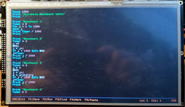

Just received my 9" ssd1963 display interfaced using Grogster's PCB
still got the screen protector on but WOW!!!
Option lcdpanel ssd1963_8_16,l
Edited by matherp 2018-12-01

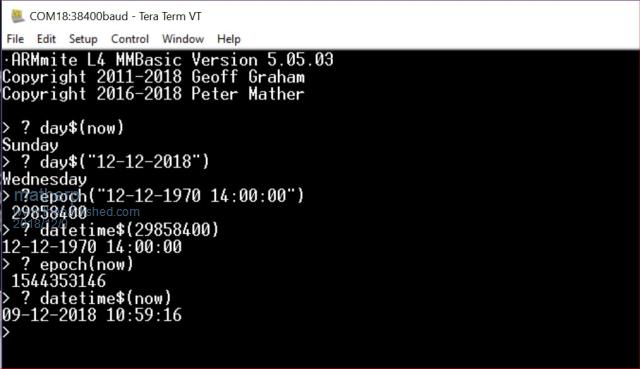

Posts: 11967
Posted: 11:16am 09 Dec 2018
Minor update that allows the EPOCH function to be used for dates before 2000 and changes the format of the day$ function as per the Pi-cromite and Armmite L4 to allow the date to be specified. EPOCH and DATETIME$ now work back to 1902 with epoch going negative before 1970.
2018-12-09_230018_Armmite1.3.zip
2018-12-09_211536_Armmite_H7_Manual.pdf

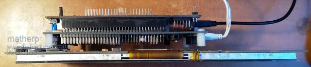

Note on the 9" BuyDisplay SSD1963 display I've found it necessary to remove all the resistors and capacitors around the SDcard socket in order to run the SDcard at full speed as needed for streaming audio using either the on-display sdcard socket, or the one on the Armmite backpack.Edited by matherp 2018-12-29
