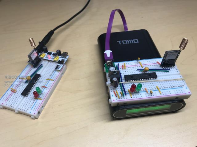

Picked up a couple of the Reyax Lora modules that work on 915Mhz for a project that would ideally get me 1.5 miles of distance between two warehouses at work. Set them up on two different breadboards with micromites controlling them. They conveniently work on 3.3v and use a simple AT command set. At full transmit power they use 43ma. After a bit of playing, I got them to play Ping Pong with each other and was able to use Geoffs brilliant RX serial interrupt on character function. (WORKS GREAT, Thanks!)
They seem to take a bit of time to communicate with each other which I find strange, but this is probably how they work to get the crazy distances??? I have one unit (base) that sends out "HELLO" and when the other unit (remote) receives that successfully, it sends back "ACK". If the base unit receives that successfully it starts the process over again. If the base doesn't receive the ACK within 3 seconds, it tries again. Without using any delays, the complete round trip takes about 1800 ms.
I have only done a quick walk around the neighborhood with the remote unit on a usb battery bank and am TOTALLY amazed at how far these go. This is not line if site, but through houses, trees, etc. Once I get a bit of time, I will add a gps unit on the remote and do some real distance testing, but so far so good. I have not gotten a great handle on these yet, but for sending packets of data to control things or receiving data from remote sensors, this might be a great way to do this.
Here is the simple code for ping pong between the units. If anyone has a suggestion on better ways to do this, I would be very receptive.

LoRa devices have a range of settings, bandwidth, spreading factor and coding rate. All of these settings affect the data rate and in essense the slower tha data rate the longer the range.
The datasheet for the Reyax tells you how to change the LoRa settings, it maybe even says what the defaults are.

@srnet, I found the AT commands manual HERE and will play around with the settings, especially the AT+PARAMETER setting where you can change the settings you mention.
This unit uses the SX1276 which is an spi device. Have you ever been able to control this directly with the micromite? Those modules are a lot cheaper without having an extra mcu to convert to uart, but that mcu does make it a bit easier to deal with. Also have you ever used the E32 type modules? These are available in 1w version and that should allow for some crazy distances.
