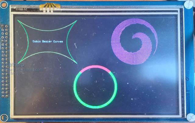

Please find attached V5.05.03
2019-01-10_194559_Armmite1.3.zip
2019-01-10_194625_Armmite_H7_Manual.pdf
This includes arc and Bezier curve drawing commands as per my recently listed CFunctions. Command syntax in the manual. It also removes the restriction on arrays having dimensions > 32767 elements
CLS
bezier 10,10,106,80,212,80,309,10,rgb(yellow)
bezier 10,230,106,150,212,150,309,230,rgb(yellow)
bezier 10,10,80,80,80,160,10,230,rgb(green)
bezier 309,10,239,80,239,160,309,230,rgb(green)
text 85,110,"Cubic Bezier Curves"
for i=0 to 99 step 4
Arc 600,120,20+i,,325+2*i,5+5*i,rgb(magenta)
next i
arc mm.hres\2,350,100,110,315,45,rgb(red)
arc mm.hres\2,350,100,110,45,315,rgb(green)

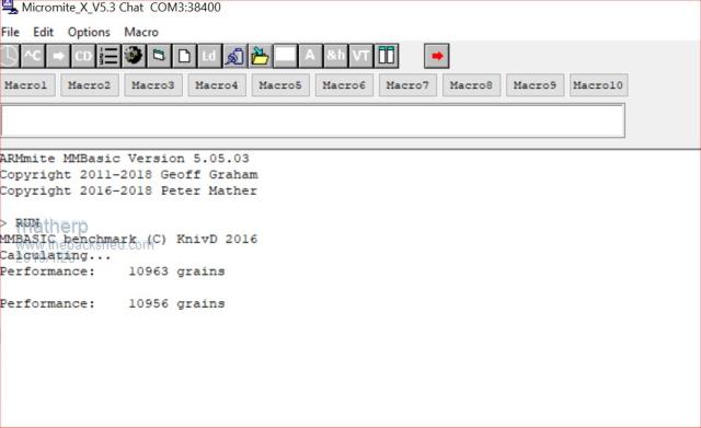

Posted: 06:41pm 27 Jan 2019
Big performance improvement for programs with strings or arrays and re-write of serial processing to fix bug and improve performance. It transpires STM32 chips hate non-aligned data (i.e. an integer should be on a 4-byte boundary). Performance on this benchmark is now much greater than 2x MMX and nearly 5x MM+ at 100MHz.
2019-01-28_043616_Armmite1.3.zip

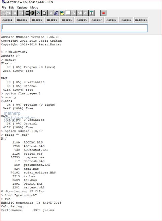

Coming soon port for STM32F767ZI (since I had one and wanted to evaluate how portable STM32 code really is)

  matherp said   Coming soon port for STM32F767ZI
Double Yay!!
I hope in time there are some suitable Nucleo-F series boards in the DIP style--32, 48, and 64 pins. They would be great micromite platforms.

  matherp said   Big performance improvement for programs with strings or arrays and re-write of serial processing to fix bug and improve performance. It transpires STM32 chips hate non-aligned data (i.e. an integer should be on a 4-byte boundary).
I forgot to report back on this change on the ARM-H7 - what surprised me was the speed improvement in some simple test code I was running in a do loop waiting for an ADC process to finish:
I was flashing a GUI led with in a crude way:
[code]
do
FlashCount = FlashCount + 1
if FlashCount = 4000 then CtrlVal(RedLED) = 1
if FlashCount >= 8000 then
CtrlVal(RedLED) = 0
FlashCount = 0
endif
loop while ADC_1 = 0
[/code]
Before the firmware change the FlashCounts were 300 and 600, I had to increase them to 4000 and 8000 with the latest firmware to get roughly the same flash rate. I assume the increase was due to underling MMBasic GUI code implementation speed increase?
AGAIN in case someone missed it: This was just a quick bit of CRUDE code to get a visual indication of the loop still running as I was developing it, in real world code the flash rate (if used) would be controlled from a timer flag, BUT then I wouldn't have noticed the execution speed change.
There is no other code, timers or interrupts running except for ADC acquisition complete interrupt.
I am yet to load the new firmware into my CNC type controller, it will be interesting to see what speed changes I see in that very big and complex program.
