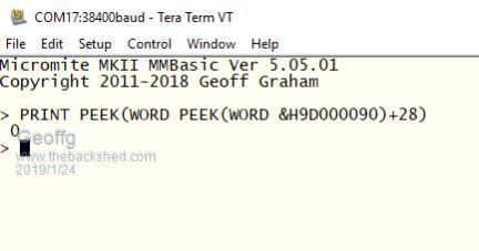

Posted: 07:01am 24 Jan 2019
i try :(in my code)
PRINT PEEK(WORD PEEK(WORD &H9D000090)+28)
i got : Error Address
Posts: 3368
Posted: 09:45am 24 Jan 2019
It worked for me:
