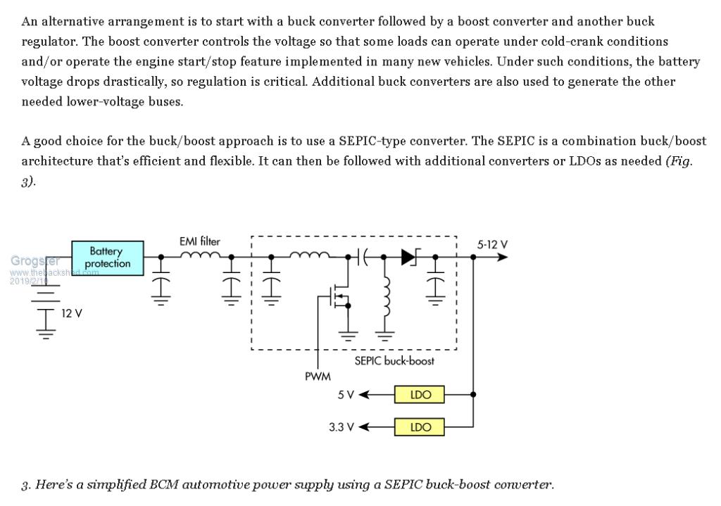

Hi folks.
I want to use one of my projects in a vehicle, but I know that vehicle electrical supplies can be a bit nasty when it comes to running an MCU on them.
Does anyone know of a filter thing, that works well as a DC filter AND as a load-dump protection/spike arrestor should the battery be disconnected with the engine(and alternator) running?
I have so far found this thing at Jaycar, but I have no idea what is in it.
I expect that it filters the DC to remove noise, but I doubt it has any load-dump protection or spike protection - but perhaps it does. I suppose I could buy one and cut it open to see what is inside it.
If something off-the-shelf is available, it would just save me having to try to spend time researching and building one. But if members know of any schematics they could recommend, so much the better and I could possibly then include it on the main PCB with everything else.
I am thinking something along the lines of this:
I already have the SEPIC buck/boost converter to deal with any input voltage from around 7v to 40v, and so am just thinking that I need an EMI filter in front of it as in the diagram above, perhaps with a juicy TVS diode or two across the filer.
Thought and opinions would be very much appreciated.
Thanks for any replies.

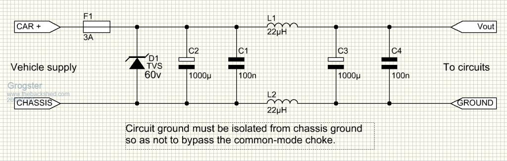

Posts: 2552
Posted: 01:39am 10 Feb 2019
mains AC is slow (50Hz), while common-mode chokes filter out the higher frequency stuff, hence they work just as well for DC. most industrial automotive electronic equipment will contain a common-mode choke on the supply input.
however, there are some design limitations. most importantly is to not 'bypass' the common-mode choke by having any solid signal ground connection emerging from inside the equipment. you can get around this by either having an isolating PSU within the equipment, or by using a loosely coupled signal ground, or by keeping any externally connected switches, etc, floating with respect to the chassis.
rob :-)
addendum, lets see if this image works:
Edited by robert.rozee 2019-02-11
Posts: 10056
Posted: 02:22am 10 Feb 2019
Ahhh, OK then. So circuit-ground must be isolated from chassis ground.
Is that correct?
This kind of idea:
I added TVS diode D1, but other then that, the rest is what I expect this filter to be.
D1 would need to be a reasonably juicy one, so it can dissipate the energy if the voltage ever peaks above 60v. But as the alternator's own regulator will pull that voltage back down to where it should be in a load-dumping situation, and that this SHOULD happen with about 100mS or so, we should only need to suppress the short spikes. I'm thinking 6A diode at least.
Thoughts?
Comments?
EDIT: Rob beat me! The SEPIC converter I am using has a common ground, but so long as IT'S ground and all the circuit ground, is on the ground side of the common-mode choke and NOT on the chassis side of the choke, that's OK - correct?Edited by Grogster 2019-02-11
Posts: 2552
Posted: 12:24pm 10 Feb 2019
TVS's normally have a phenominal current/power rating (1000A or more) but only for a very short time. you may get good milage by putting a polyfuse in place of the regular fuse - it has been over a decade since i played with these things, and my memory is a little fuzzy.
you can make a weak connection between circuit ground and chassis ground, for example through a 100 ohm resistor, but then noise on the 12v supply will be superimposed upon the signal you are measuring. this may or may not be an issue in your application - for a digital input the noise may be well below the switching threshold, for an analog input you may be able to filter out the noise in software.
alternatively, use optocouplers for digital I/O and differential input buffers for analog inputs.
