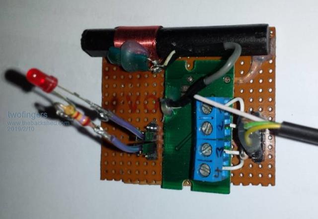

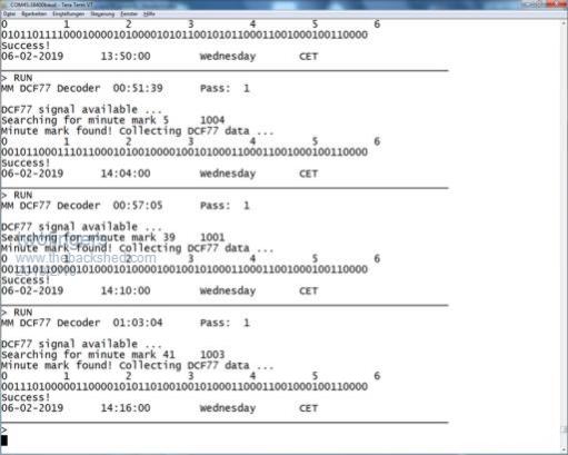

This is yet another DCF77 Decoder.
I fear it will only interest Europeans. Because of
  Quote  DCF77 is a German longwave time signal and standard-frequency radio station.
DCF77 on Wikipedia
The code is well commented and tested.
I used a very old (~30 years?) DCF77 module from Conrad Electronics in germany.
The red LED is pulsing at 1 Hz and indicates the DCF77 signal.
My module is connected to the MM2 with a 2m telephone cable.

2019-02-10_233412_mm_dcf77.zip
Any comments welcome.
Michael
