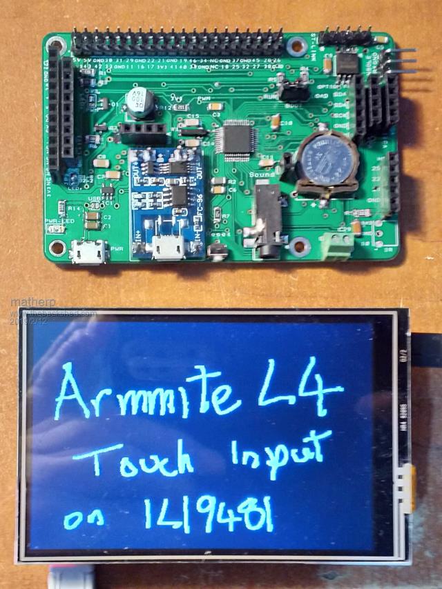

Please find attached Version 5.05.07
2019-02-12_033710_ArmmiteL4.zip
This includes support for touch as per the MM2 and also support for the ILI9481 displays and is now "complete" in terms of what I am trying to achieve with the L4 port.
OPTION LCDPANEL ILI9481, orientation, DCpin, RESETpin, CSPin
SPI connections to touch are the same as the LCD displays and Flash memory (SPI2).
Configurations on the L4 backpack PCB (V1.4 gerbers and schematic attached) are:
Option flash 2
Option lcdpanel ili9481,l,21,19,46
option touch 34,11
or
Option flash 2
Option lcdpanel ili9341,l,5,6,20
option touch 19,18
2019-02-12_045216_HAT64_-_Project.pdf
2019-02-12_045234_HAT64V1.4.zip
The picture shows a version 1.3 PCB which doesn't have touch connections to the ILI9341 header. These are included in 1.4.
