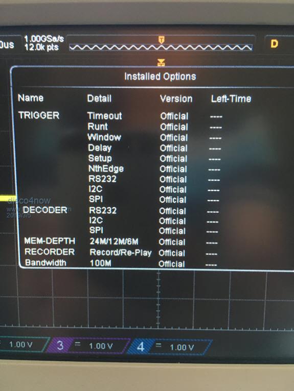

disco4now
Joined: 18/12/2014
Posts: 1157
Posted: 02:03am 05 Mar 2019
does that unlock the serial analyser features too?
Yes,but I have not used it.see below.
Unlocks addition triggering options,decoding of R232, I2C and SPI, 100MHz and the 24Meg memory.

I have that Rigol unit, a couple of years ago I needed to investigate class D audio amplifiers. What I liked was the single shot and recording those to USB. For me it is a good general purpose unit.
A few days ago I needed to do some simple checking on a charge pump circuit and was disappointed to find that I had forgotten a lot about how to operate the unit. One of above posts reminded me, I thought spot on.
One thing that had me excited was
  Quote  Unlocks addition triggering options,decoding of R232, I2C and SPI, 100MHz and the 24Meg memory.
I was aware of the unlocking but I don't think I got around to do that. So I have never found out how well that works. Edited by plover 2019-03-07
