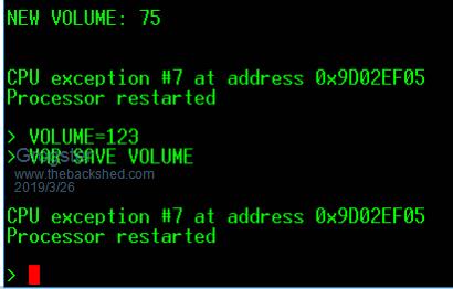

This seems to happen when I try to VAR SAVE.
Anyone got any ideas?

The code falls over with the same error, in the line of the code above, when I try to save the VOLUME variable with VAR SAVE. If I END or comment that VAR SAVE line out, the code proceeds to the next part of code as it should.
MMBASIC version 5.0501 on a 170 Micromite 44-pin chip.

Posts: 10056
Posted: 10:25pm 26 Mar 2019
VOLUME is DIM'ed as an Integer at the top of the code - before the main loop starts.
VOLUME defined as an integer inside the SELECT CASE routine.

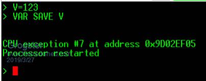

I use MMEDIT to write the code, but I use GFXterm to copy the code across - I don't use the RUN button in MMEDIT. This is just how I have come to do it. EDIT: I get the code to where I want it in MMEDIT, then CTRL-A copy-all, right-click/Copy. Go to GFXterm window, type AUTOSAVE, then paste from clipboard.
I commented out the PRINT line directly below the VAR SAVE - Still get the same exception. The fact that once the processor has restarted, if I just define any variable at the command prompt and then try to save it(as in the GIF image I added), this also generates the same error suggests something is wrong....
EDIT: Like this.....
