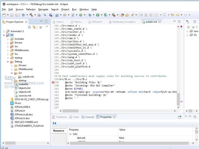

Compilation/build for the F4 failed with something deep in subdir.mk, but I can't figure out what the problem is:
There also appears to be something wrong/missing in stm32F4xx_hal.h relating to HAL_StatusTypeDef settings, and ff.h: "#error Wrong configuration file (ffconf.h)."
Is the USB OTG FS needed?
Now that I better understand the steps, I'm installing CubeMX and the IDE on a different PC, and will retry the build. So much of this is so nicely automated, I'm afraid if I just stick in what seems to be needed, it will be too scattershot an approach.

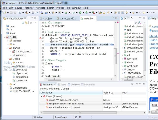

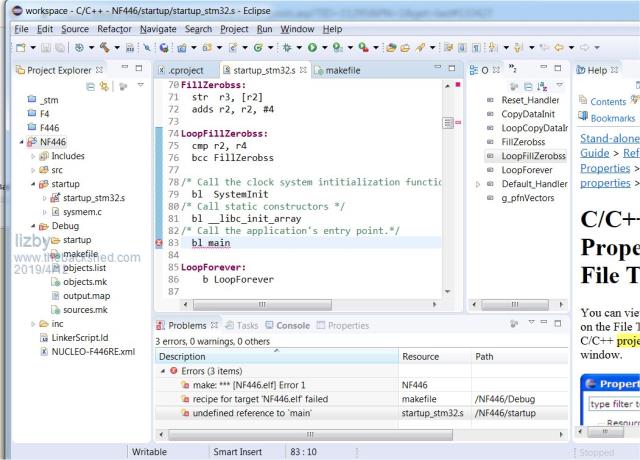

Still stuck--or stuck again. For a time it was a project which did not have the little "C" mark on the project icon, and so had no "C/C++ Build" or "C/C++ Properties" in Project Properties. After failing to figure out out to make it a C project, I started over today, generating the project code from CubeMX and making a C project.
Now I have the "C" mark on a new project and set the properties as suggested and copied in the Src and Inc files. I get three failures after trying to build (or perhaps it's one failure which cascaded).
Here are screenshots:
There are differences between the two files shown above and the corresponding files in the H7 project, but I don't know enough to tell whether they are significant.
Any ideas?
