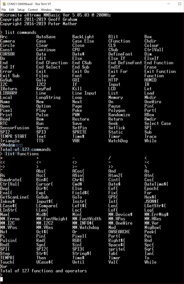

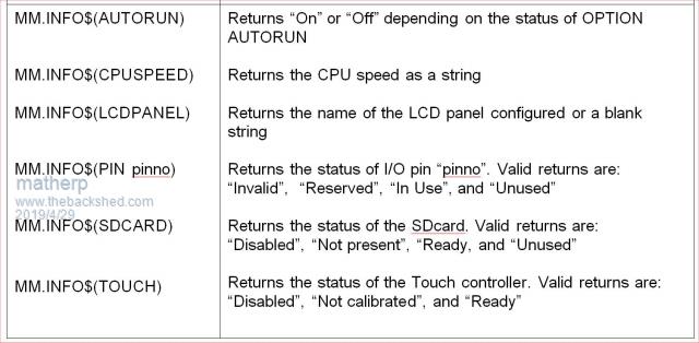

This version includes mp3 playback over the I2S output port as well as flac file playback. It also includes a new information function MM.INFO$() as well as "LIST FUNCTIONS" and "LIST COMMANDS"

This is something to do with MM.INFO$ but I haven't tracked down the problem yet.
if you force these lines as an error then the program will work
On error ignore
txt=MM.INFO$(somethinginvalid) ' change from AUTORUN
On error ABORT
I'll post an update when I find the problem

Fix to MM.INFO$(CPUSPEED) which was the only bit not cut-and-paste from the Armmite
