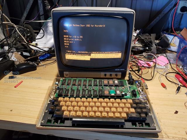

Hi Guys
Finding time to get back to the electronics bench. Cleaned up the area, tested the test gear, even bought myself a desoldering station.
I dug up my old Microbee 16 computer. Last time I tried it didnt work, and I knew from previous use the core board edge connectors would cause me all sorts of trouble, so they were the first to get replaced with new sockets and pins strips.
Next I powered it up, it was drawing 5 amps at 12v, and smelt a little smoke. Found a 4.7uF 25v tantalum cap short circuit ( no surprise ), replaced it. I also replaced a 33uF 6.3v electrolytic on the core board.
Powered it up again, and heard a familiar "beep". Connected a monitor, and I can see the start up text.....
Applied Technology blah blah
Copyright blah blah
But no prompt, and no response from the keyboard. If I do a warm reset, it comes up with the "Ready" text, but again, no prompt.
Any suggestions on where I should go from here? Look like the CPU is alive, video working, so I'm hopeful. Something in the boot process is causing it to stop.
Doesn't sound like you have a RAM battery fitted but if you do I'd remove it to ensure you have no spurious RAM content affecting the boot. A few other thoughts that might help...
  Boppa said
If I remember the bee actually copies the OS into ram during the boot procedure
You may be thinking of disk based Bees which run CP/M and do copy the boot ROM content into RAM for execution. ROM based Bees (like this one) don't do that. The boot process for these machines executes directly from the Basic ROM starting at 8000h. It does read and write RAM during the boot process to establish the Basic scratchpad content etc but doesn't execute any RAM resident code AFAIK.
  Gizmo said
If I removed the EDSAM ROM's, it wont boot at all.
That behaviour is not normal and may be a clue to the problem. A normal boot to Basic does not require the EDASM ROMs to be present and shouldn't be executing any code from them. I'd be tempted to remove them and just remove that variable from the troubleshooting, even though that seems to be making it worse.
  Gizmo said
There is also a ROM on the main board, which must contain the boot loader, and graphics characters at least. Plus the screen and PCG ram chips.
That EPROM (or mask ROM in some machines depending on age) is just the video font ROM. There is no boot code in it so unlikely to be related if you're getting a good character display.
My suspicion, if its not a simple bad connection or partially dead EPROM or RAM chip, would be something amiss with the keyboard scanning circuitry. The 6545 (video chip) drives keyboard scanning as well as generating the video display and the 2 functions are somewhat interrelated so the missing prompt display and non-working keys may be 2 symptoms of the same problem. Possibly related to the *ROMREAD signal - IC33 & 34 are involved in generating that signal so would be worth having a look at.

  Gizmo said  This makes me think the BASIC scratchpad in RAM is ok. From memory the first 128 bytes of RAM were used for scratch and some system parameters, I remember poke-ing them as a kid.
Makes sense. Most of the RAM below 0900h is used by Basic for one thing or another. The first 128 bytes are hires graphics scratchpad I think.
  Gizmo said  The graphics ROM on the board is obviously OK, as is the screen RAM. When it did boot into the EDSAM, most of the keys were working, and the others started to come good, so the 6545 is probably OK, but I'll look at the ROMREAD signal.
Interesting. That would point to there not being any hardware problem with the key scanning I guess, though I wouldn't rule it out just yet as there may be differences. For instance, Basic switches the font ROM into the memory map to read its contents and generate inverse characters that are then stored in the PCG. EDASM may not do that as I suspect it doesn't need inverse characters.
However, if things are working OK in EDASM then you can probably run the built-in Monitor which will give you access to low level commands that you can use for troubleshooting, RAM tests etc. You can enter the monitor by holding down M during a reset or the X command from EDASM. This will probably tell you everything you ever wanted to know about Monitor commands and then some - Microbee Monitor Commands
I see you've started an MSPP thread for this too so that will help. If you search the forum for a thread called "Hello from Sweden" you'll see someone else with a similar problem from a while back and lots of troubleshooting ideas. Unfortunately the thread went off topic a bit and then went cold before it reached a conclusion on the original boot/keyboard issue but something there might be helpful.

Wizged thanks for that, I had forgotten about the Monitor.
M & Reset fired up the Monitor. I did a echo test and about half the keys are working. I soldered a couple of wires to one that wasn't ( the space key ), and by shorting the wire I get a space, so the key switch issues are mechanical problems.
Next I tried the memory dump, it also worked, I could see the scratch pad in RAM was full data, and the ram after that (80h ) was all 00h. Next I jumped up to 8000h and could see the ROM data.
Got called away, will get back to it later and test if I can see data in all BASIC ROM locations. At least that will tell be if its a completely dead ROM or not.
While in Monitor I did try B to load up Basic, but same result, intro text but no cursor. Something happens between the intro text and the start of the waiting for user input thats locking up the Bee.

Making good progress with the Bee, thanks to Wizged's suggestion to use the EDSAM Monitor program, and a lot of help from the forum and online documentation over at the Microbee Software Preservation Project (MSPP) https://www.microbee-mspp.org.au/.
Used Monitor to dump the BASIC ROMS into a wave file, using the Microbee cassette interface into my laptops audio plugs, and the guys over at MSPP confirmed the ROM appeared OK. Its also good to know the cassette interface is still working, so I can save and load programmes into the Bee using a PC recording or playing the wav files. Neat, most of the old Microbee software is available in this format.
Next I used Monitor to test ram, and this is where the problem was. The 2nd 2k CMOS RAM chip wasn't responding. I swapped the ram chip with another, but no difference, so it was a addressing issue. Poking around with my CRO on the RAM CS ( Chip Select ) line pin pointed a 4053 IC with a bad input. Swapped out the 4053 with a good one and the Bee burst into life!

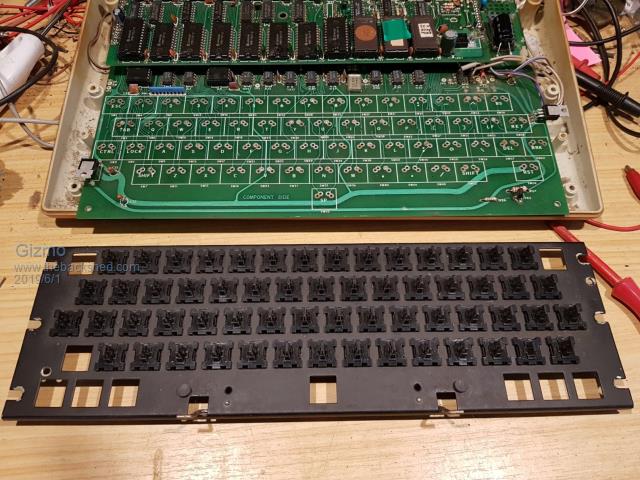

Next step is to fix the keyboard, half the keys dont work and I was shorting wires to use the Monitor program.

I removed the keyboard, tested and pulled most of the key switches apart, wiped the contacts and rubber contact with some rubbing alcohol. There is a documented mod to replace a 3.3k resistor array for the keyboard with a 33k, I discovered my resistor array were 4.7k, and the only replacement I had was a 10k, so fitted that.
Put it all back together and I still have a couple of keys that are not as responsive as they should be, so I might order in a 33k resistor array.
A couple of restarts later, the Bee beeped as usual, but no screen. It was dead again, but a different fault. The address and data lines seamed to have normal activity, but the keyboard and screen were totally off line, which points to the 6454 IC. Poking around with the cro and I could not see the 12MHz clock signal to the chip, tracked that back to a 74LS161 near the crystal oscillator. Replaced it with a 74161 from my parts drawer, and once again the Bee burst back into life.
Next I dug up a genuine Microbee amber monitor I picked up a couple of years ago ( Thanks Rod ). First thing was to take the back off and check for dry joints, etc. Resoldered a few, and noticed the mains transformer seamed to be awful big for a small monitor. I also noticed a 12v plug on the back of the monitor. Light bulb moment, this monitor is designed to power the Microbee.
All back together and running.

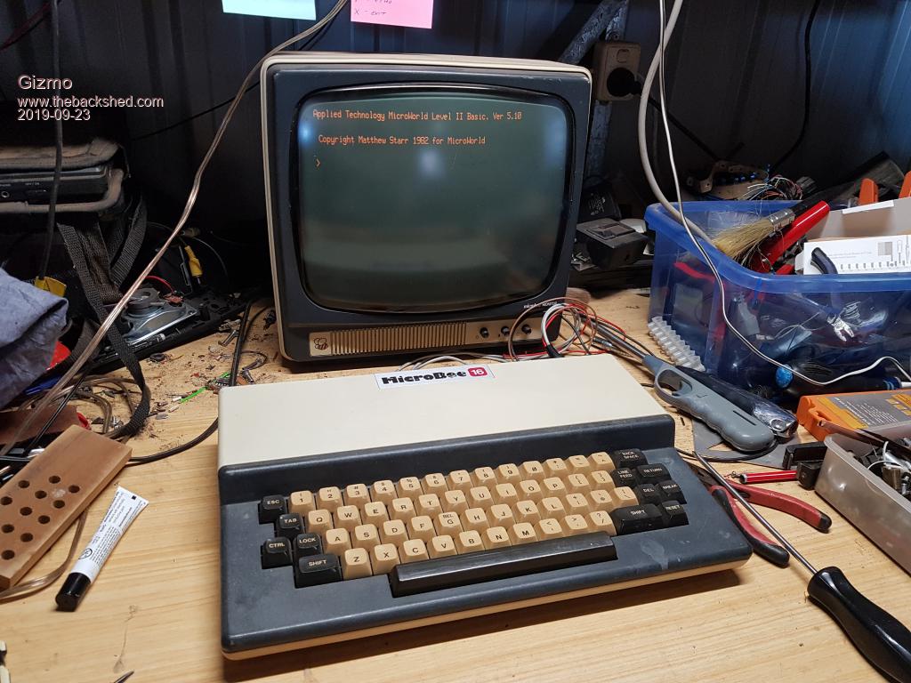

Posts: 5199
Posted: 06:53am 23 Sep 2019
Well its finished.
I left the case in the sun for a few days, definite improvement in the yellowing. Also repaired a few key switches with conductive paint.
Feels like reuniting with a old friend.
