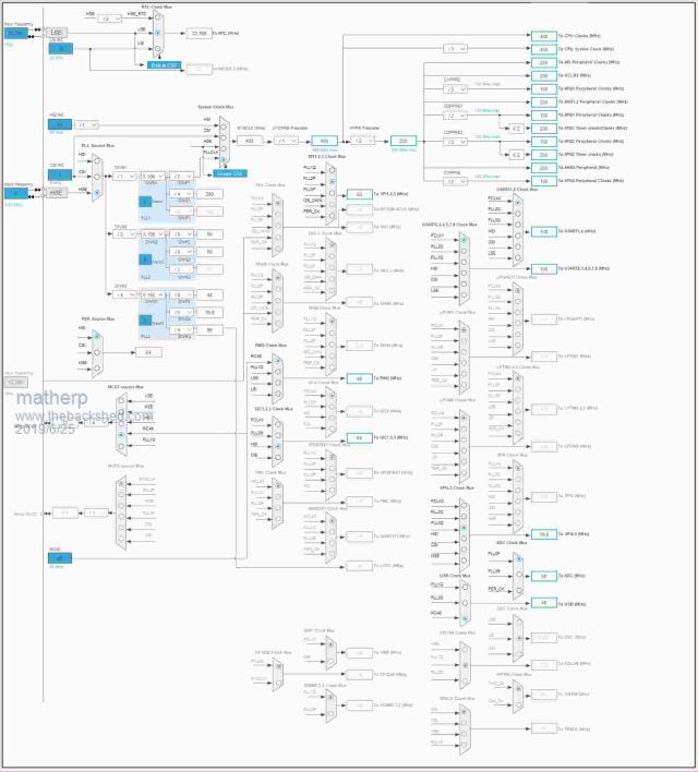

Posts: 11968
Posted: 07:05am 25 Jun 2019
  Quote  I was only interested in processor clock speed. Not how the Port to the ARM handles clock speed.
It is the Port to the ARM that sets the processor clock speed. Nothing runs without a lot of code setting up multiple PLLs. Because MMBasic has lots of real time functionality, all this can be affected by clock changes
void SystemClock_Config(void)
RCC_OscInitTypeDef RCC_OscInitStruct;
RCC_ClkInitTypeDef RCC_ClkInitStruct;
RCC_PeriphCLKInitTypeDef PeriphClkInitStruct;
/**Supply configuration update enable
MODIFY_REG(PWR->CR3, PWR_CR3_SCUEN, 0);
/**Configure the main internal regulator output voltage
__HAL_PWR_VOLTAGESCALING_CONFIG(PWR_REGULATOR_VOLTAGE_SCALE1);
while ((PWR->D3CR & (PWR_D3CR_VOSRDY)) != PWR_D3CR_VOSRDY)
/**Configure LSE Drive Capability
HAL_PWR_EnableBkUpAccess();
__HAL_RCC_LSEDRIVE_CONFIG(RCC_LSEDRIVE_LOW);
/**Macro to configure the PLL clock source
__HAL_RCC_PLL_PLLSOURCE_CONFIG(RCC_PLLSOURCE_HSE);
/**Initializes the CPU, AHB and APB busses clocks
RCC_OscInitStruct.OscillatorType = RCC_OSCILLATORTYPE_HSI48|RCC_OSCILLATORTYPE_HSI
|RCC_OSCILLATORTYPE_HSE|RCC_OSCILLATORTYPE_LSE;
RCC_OscInitStruct.HSEState = RCC_HSE_ON;
RCC_OscInitStruct.LSEState = RCC_LSE_ON;
RCC_OscInitStruct.HSIState = RCC_HSI_DIV1;
RCC_OscInitStruct.HSICalibrationValue = 16;
RCC_OscInitStruct.HSI48State = RCC_HSI48_ON;
RCC_OscInitStruct.PLL.PLLState = RCC_PLL_ON;
RCC_OscInitStruct.PLL.PLLSource = RCC_PLLSOURCE_HSE;
RCC_OscInitStruct.PLL.PLLM = 1;
RCC_OscInitStruct.PLL.PLLN = 100;
RCC_OscInitStruct.PLL.PLLP = 2;
RCC_OscInitStruct.PLL.PLLQ = 4;
RCC_OscInitStruct.PLL.PLLR = 2;
RCC_OscInitStruct.PLL.PLLRGE = RCC_PLL1VCIRANGE_3;
RCC_OscInitStruct.PLL.PLLVCOSEL = RCC_PLL1VCOWIDE;
RCC_OscInitStruct.PLL.PLLFRACN = 0;
if (HAL_RCC_OscConfig(&RCC_OscInitStruct) != HAL_OK)
_Error_Handler(__FILE__, __LINE__);
RCC_ClkInitStruct.ClockType = RCC_CLOCKTYPE_HCLK|RCC_CLOCKTYPE_SYSCLK
|RCC_CLOCKTYPE_PCLK1|RCC_CLOCKTYPE_PCLK2
|RCC_CLOCKTYPE_D3PCLK1|RCC_CLOCKTYPE_D1PCLK1;
RCC_ClkInitStruct.SYSCLKSource = RCC_SYSCLKSOURCE_PLLCLK;
RCC_ClkInitStruct.SYSCLKDivider = RCC_SYSCLK_DIV1;
RCC_ClkInitStruct.AHBCLKDivider = RCC_HCLK_DIV2;
RCC_ClkInitStruct.APB3CLKDivider = RCC_APB3_DIV2;
RCC_ClkInitStruct.APB1CLKDivider = RCC_APB1_DIV2;
RCC_ClkInitStruct.APB2CLKDivider = RCC_APB2_DIV2;
RCC_ClkInitStruct.APB4CLKDivider = RCC_APB4_DIV2;
if (HAL_RCC_ClockConfig(&RCC_ClkInitStruct, FLASH_LATENCY_2) != HAL_OK)
PeriphClkInitStruct.PeriphClockSelection = RCC_PERIPHCLK_RTC|RCC_PERIPHCLK_USART3
|RCC_PERIPHCLK_USART2|RCC_PERIPHCLK_USART6
|RCC_PERIPHCLK_USART1|RCC_PERIPHCLK_UART5
|RCC_PERIPHCLK_RNG|RCC_PERIPHCLK_SPI5
|RCC_PERIPHCLK_SPI3|RCC_PERIPHCLK_SPI1
|RCC_PERIPHCLK_SPI2|RCC_PERIPHCLK_I2C2
|RCC_PERIPHCLK_ADC|RCC_PERIPHCLK_I2C1
|RCC_PERIPHCLK_USB;
PeriphClkInitStruct.PLL2.PLL2M = 2;
PeriphClkInitStruct.PLL2.PLL2N = 100;
PeriphClkInitStruct.PLL2.PLL2P = 8;
PeriphClkInitStruct.PLL2.PLL2Q = 8;
PeriphClkInitStruct.PLL2.PLL2R = 8;
PeriphClkInitStruct.PLL2.PLL2RGE = RCC_PLL2VCIRANGE_2;
PeriphClkInitStruct.PLL2.PLL2VCOSEL = RCC_PLL2VCOWIDE;
PeriphClkInitStruct.PLL2.PLL2FRACN = 0;
PeriphClkInitStruct.PLL3.PLL3M = 4;
PeriphClkInitStruct.PLL3.PLL3N = 192;
PeriphClkInitStruct.PLL3.PLL3P = 8;
PeriphClkInitStruct.PLL3.PLL3Q = 5;
PeriphClkInitStruct.PLL3.PLL3R = 4;
PeriphClkInitStruct.PLL3.PLL3RGE = RCC_PLL3VCIRANGE_1;
PeriphClkInitStruct.PLL3.PLL3VCOSEL = RCC_PLL3VCOWIDE;
PeriphClkInitStruct.PLL3.PLL3FRACN = 0;
PeriphClkInitStruct.Spi123ClockSelection = RCC_SPI123CLKSOURCE_PLL2;
PeriphClkInitStruct.Spi45ClockSelection = RCC_SPI45CLKSOURCE_PLL3;
PeriphClkInitStruct.Usart234578ClockSelection = RCC_USART234578CLKSOURCE_D2PCLK1;
PeriphClkInitStruct.Usart16ClockSelection = RCC_USART16CLKSOURCE_D2PCLK2;
PeriphClkInitStruct.RngClockSelection = RCC_RNGCLKSOURCE_HSI48;
PeriphClkInitStruct.I2c123ClockSelection = RCC_I2C123CLKSOURCE_HSI;
PeriphClkInitStruct.UsbClockSelection = RCC_USBCLKSOURCE_HSI48;
PeriphClkInitStruct.AdcClockSelection = RCC_ADCCLKSOURCE_PLL2;
PeriphClkInitStruct.RTCClockSelection = RCC_RTCCLKSOURCE_LSE;
if (HAL_RCCEx_PeriphCLKConfig(&PeriphClkInitStruct) != HAL_OK)
HAL_RCC_MCOConfig(RCC_MCO1, RCC_MCO1SOURCE_HSI48, RCC_MCODIV_4);
/**Configure the Systick interrupt time
HAL_SYSTICK_Config(SystemCoreClock/1000);
HAL_SYSTICK_CLKSourceConfig(SYSTICK_CLKSOURCE_HCLK);
/* SysTick_IRQn interrupt configuration */
HAL_NVIC_SetPriority(SysTick_IRQn, 0, 0);
Edited by matherp 2019-06-26

Posted: 10:01pm 25 Jun 2019
I tried to reply last night but the forum keep loosing a connection from my location.
I'm thinking that I will have to re-word my reply's in this forum as they seem to be taken out of context?
My comment above was to indicate that I wanted to know if the CPU is indeed a 480Mhz part and not testing under the timing constraints of running under mm.basic. It was not a slight on the Port to ARM, I understand the complexities of internal scaling and PPL control of timing and final internal clock speed, hence my comment.
It was a curiosity thing as the CPU's appear to be the same part number, but obviously, as in the past, that is no indication of the speed capability of the part, I was hoping the ARM had not gone down the Microchip's path.
IE: Same part number and ID but sold as different speed parts with no way of really knowing if you got the correct part. I got burned by this with the M100 120Mhz.
Anyway, just now I see that you have been busy coding an option for CPU speed and this is really fantastic, thankyou once again for the time and effort.
