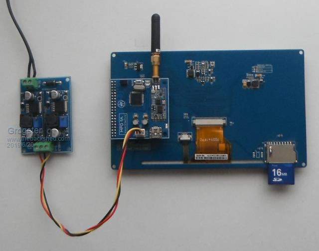

7" SSD1963 panel, with minimal 64-pin MM+ chip to control the screen.
Works.
.....until you turn off the power. When I cycle power, the LCD does NOT re-initialize. No GUI commands work, including GUI TEST LCDPANEL. Nothing can be drawn on the screen. The BACKLIGHT command has no effect.
The only way I can get it to work again, is to:
OPTION LCDPANEL DISABLE
...and then....
OPTION LCDPANEL SSD1963_7,L
Then it works again just fine - until I turn off the power again, and then we are back to the same issue in that I have to disable and re-enable the LCDPANEL before it will work again.
I have never seen this behaviour before. Can anyone suggest anything that might be causing this issue?
3v3 and 5v connected to 7" panel, via two external buck-converter modules. I will upload some photos shortly, of how I have everything connected.
EDIT: Here is the photo of my arrangement:
The MM+ board talks to the 7" LCD, and the PSU on the left of the image takes a 12v input and provides a 3v3 and 5v supply to the MM+ board.Edited by Grogster 2019-06-21
Posts: 10056
Posted: 03:45am 20 Jun 2019
I tried a brand-new 7" LCD on this just now, and exactly the same problem. Changed 100uF caps just above the 3-way connector on the MPD board, to 1000uF 6v3 thinking perhaps there was some kind of voltage-drop issue, but that also did not help.
Stumped.

Posts: 3368
Posted: 04:02am 20 Jun 2019
I wonder if the MM+ is kept powered on somehow. Perhaps the USB-to-Serial bridge is somehow supplying the power? Then, when you cycle the power, only the LCD panel would be reset.
Do you get an error message when you access the LCD panel?
What happens when you use GUI RESET LCDPANEL ?
EDIT: The other possibility is that the Reset pin on the SSD1963 panel is not connected to the Micromite.
GeoffEdited by Geoffg 2019-06-21
Posts: 10056
Posted: 04:09am 20 Jun 2019
Definitely not the USB, as that is not connected when I cycle the power when I have this problem, so it SHOULD just restart. IE: Can't be parasitic power, and the MPD board does not route the UBB 5v line past the USB socket.
It's really odd. This is not my first LCD either....
No error messages when I type something like GUI TEST LCDPANEL, but you just get nothing on the screen at all. DISABLE and OPTION LCDPANEL and you are away again.
I had forgotten about GUI RESET LCDPANEL - thanks for the prod. I will add that to the code after, say, 1 second of startup delay.
Posts: 10056
Posted: 04:17am 20 Jun 2019
OK, Geoff is onto something here....
GUI RESET LCDPANEL revives the LCD if it does not fire up correctly, and then the LCD is working again without having to do the DISABLE and OPTION LCDPANEL.
When I put that at the top of my code, the screen is working 100% of the power cycles now.
Thanks, Geoff!
EDIT: "The other possibility is that the Reset pin on the SSD1963 panel is not connected to the Micromite." No, it is connected to pin 28 on this board. Edited by Grogster 2019-06-21

Posts: 3368
Posted: 08:50am 20 Jun 2019
The fact that GUI RESET LCDPANEL works suggests that the Micromite is powering up before the SSD1863... something to do with the power supply sequencing perhaps?
You could delay the Micromite startup with a capacitor on MCLR but probably the simplest is to just keep using GUI RESET LCDPANEL.

Posts: 10056
Posted: 07:25am 21 Jun 2019
@ Geoff - Yeah, I would have thought so too, but both the LCD and the MM+ are being fed from the same 3v3 supply. The 5v supply, is only there for the HC12 and the 7" LCD backlight - the "5v" pin. For whatever reason, the manual reset totally fixes the problem, so I am a happy chappy.
@ CaptainBoing - I would, if you have ever had problems with LCD initialization. This has been a non-issue for me up until now. The LCD always initializes fine. But at least we have the manual reset command, cos without it, we'd really be stuck.
