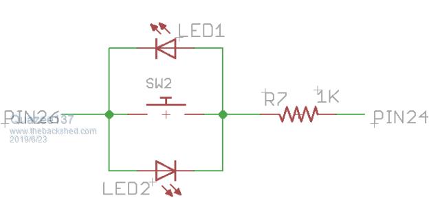

Was trying to get a bit more from the 28 pinner.
I needed a bipolar led an a button.
So took the led and added the button.
and to test the idea.
Print "Off Red Green Button"
Input "O,R,G,B ";k$
Select Case k$
Case "o","O"
off
Case "r","R"
red
Case "g","G"
green
Case "b","B"
button
Print "Button = ";b
End Select
Sub off
SetPin 24,din
SetPin 26,din
End Sub
Sub red
Pin(26)=0
Pin(24)=1
SetPin 26,dout
SetPin 24,dout
End Sub
Sub green
Pin(26)=1
Pin(24)=0
SetPin 26,dout
SetPin 24,dout
End Sub
Sub button
Local p24,p26
p24=Pin(24)
p26=Pin(26)
Pin(24)=0
SetPin 24,dout
SetPin 26,din,pullup
b = Pin(26)
SetPin 26,dout
Pin(24)=p24
Pin(26)=p26
End Sub
nice on how far and easy MMBasic lets us push this little one.
