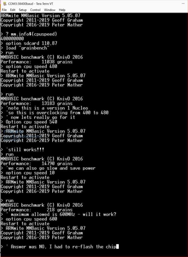

Note: If you overclock and the processor doesn't run you will need to re-flash. Other ways of resetting can't work in this case. The test above was run on a V1 Nucleo so only specced for 400MHz but ran fine at 540MHz!!!

I'm waiting for connectors before I can run the V2 board, for fun I tried to see if the V1 board would overclock as your unit did.
I decided to test with my full CNC controller program, everything worked except for the USB Keyboard, the console allowed me to change back to 400. Max Speed before the USB Keyboard stops is 420.
However the controller runs everything fine even at 480Mhz. No real advantage though so it's back at 400.

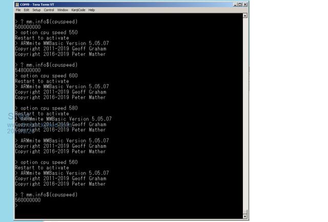

Peter, thanks for the updated firmware with ability to change CPU clock rate on the ARMmiteH7.
I can push the clock rate on my NUCLEO-H743ZI2 to 560MHz. However it is does not boot at 580MHz or 600MHz.
