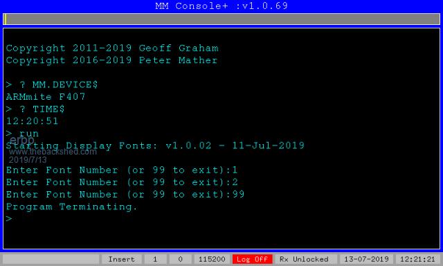

The following are details of the project I have just completed, which may be of interest to some.
It is using one Micromite as the Console for any other Micromite that it is connected to. This project came about as I didn't have a PC located in my workshop, so I found I was spending more time moving MM's, modules, test equipment, power supplies, etc., from the workshop to where the computer is located (and back again) than I was in productive development and testing. I thought - "why not use a Micromite to act as the Console, why do I need a computer, after all it just needs a serial comms link?" So after a small proof of concept project was successful and I got quite excited about the idea of not needing a PC to do many of the tasks related to "doing MM stuff", the MMConsole Plus (MMConsole+) project was born. Although I now have a computer in the workshop, I find I only use it for loading firmware to Mites, major development coding, reading TBS and the occasional Googling to get the answer (or not) to a vexing question. I much prefer to use MMConsole+ to work with other Mites.
Below is a screen shot of one of the main screens of MMConsole+ acting as the console for a connected ARMmite F4 and running a few commands, including initiating a program that I had just uploaded to the F4 via MMConsole+.
Below is a slightly reformatted extract (in blue) from the first couple of sections of the MM Console+ User Guide document included in the attached release package. This gives more high level detail on functionality and hardware requirements. If you feel this might be something that you would be interested in, the User Guide provides a lot more details including over 20 screen shots.

MM Console+ is a MMBasic program designed to run on a Micromite Plus device and provide Console and related functionality when connected to any other Micromite device thus replacing the need to connect to a PC to act as the Console. In this document, the Micromite Plus device running the MM Console+ program will be referred to as the Console MM while the Micromite device whose console it is connected to will be referred to as the Target MM.
Specifically, it provides the following functions:
1. Basic Console Access - i.e. the ability to enter MMBasic commands at the MMBasic Prompt on the Target MM and to display output messages received from the Console of the Target MM.
2. Console Logging - all console messages can be logged to a log file stored on the SD Card of the Console MM. Logging can be enabled/disabled at any time and new log messages can be appended to an existing log file if desired.
3. Console Log File Viewing - the contents of an existing log file (must be a log file created by MM Console+) can be viewed and scrolled through as well as searching for occurrences of a specific word or text string in the log file.
4. Lite Editor - provides limited editing capability for MMBasic program (.bas) files stored on the SD Card of the Console MM. The editor is intended for small tweaks, corrections and similar maintenance type activities, it is NOT intended to support full-blown program development from scratch (refer to the Lite Editor section in the User Guide document for more details).
5. Program Crunch - provides the ability to "crunch" an existing MMBasic program file stored on the SD Card of the Console MM. The "crunched" file is saved with a different name so it does not overwrite the original source file. Statistics for the crunch process are displayed, including the % of file space saved, the file size of both original source and crunched files (in number of lines and in bytes), as well as the elapsed time taken to perform the crunch process.
6. Program Upload - a MMBasic program file stored on the SD Card of the Console MM can be uploaded to the Target MM. This uses the XMODEM RECEIVE method.
Optionally the file may be Crunched as part of the upload process, with the crunched version of the file also being saved, as well as the crunch statistics (as described above) being displayed.

Attached is an updated version of MMConsole Plus (version 1.0.70).
This version fixes a bug that caused certain commands entered via MMConsole+ when the Target MM was an ARMmite F4 (or possibly ARMmite L4 or H7) to not complete properly and the Command Prompt was not re-displayed until a Break (Ctrl-C) was sent to the Target MM. Commands known to be impacted were: most OPTION ... commands, GUI CALIBRATE and possibly others. This has been fixed in the updated version attached.
