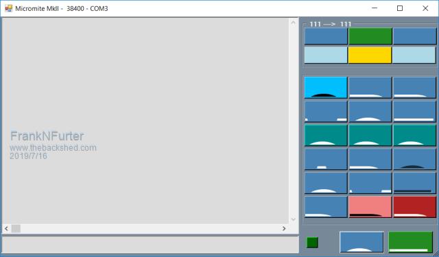

Hi,
your program looks a little weird to me:
Probably it's because I have to set a text size of 175% because otherwise the font on this monitor is too small...
Frank

Posted: 07:36am 16 Jul 2019
The top two buttons towards the right, Green and Blue, these set the Text Size. Green for the Receive buffer and the Blue button for the button text. Like I said it was just thrown together, you should be able to adjust them as they use windows font dialogue controls.

Frank N. Furter
Joined: 28/05/2012
Posts: 1154
Posted: 09:44am 16 Jul 2019
Hi Mike,
it works now! The button text font size was set to 108 and the Receive buffer font size to 1425 by default...
After I set both to 18, everything's okay.
However after a new unpacking and starting the values are again on 108 and 1425...
Thanks for your program!
Frank
