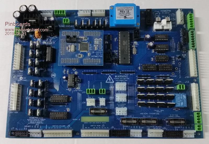

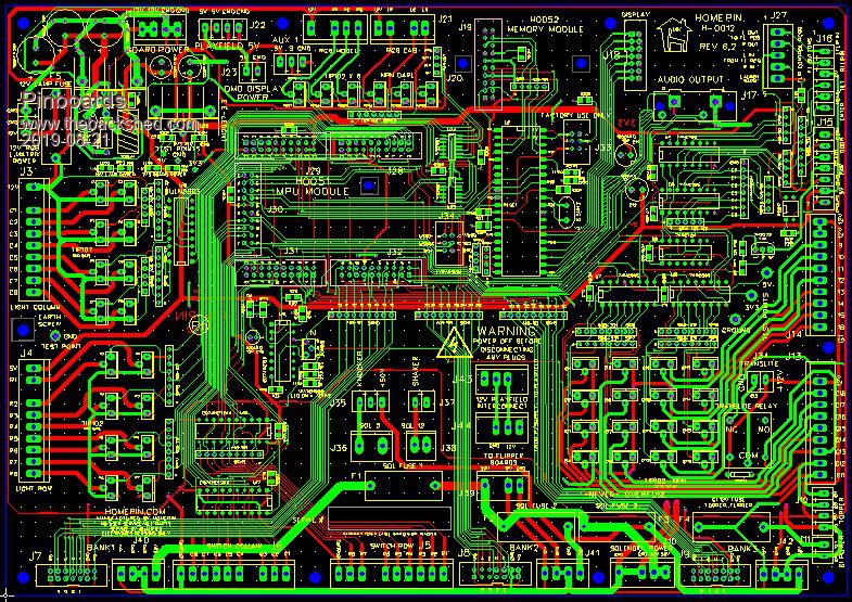

I have used 'FreePCB' for many years now. It works well with no glitches, no size limitations and is not over complicated like some of the others (including many expensive programs).
http://www.freepcb.com/
We use it in a commercial environment with great success. It certainly does everything we need quickly and easily. I'm advocating FreePCB because it seems to fall between the cracks and not many are aware of it.
I have tried all the usual suspects, Kicad, Diptrace, Altium (purchased at great expense)and others and they always seem to have some limitation - max number of pads (unless you buy it) or some crazy file types. Some have a learning curve that I'm not interested in following. FreePCB generates bog standard Gerber files that are accepted by every Chinese board house we have used over the past 5 years without question.
A note that it is written for Windows so AFAIK no Apple version.
One of our larger boards that we designed using FreePCB:

That is a very complex board board you have there.
