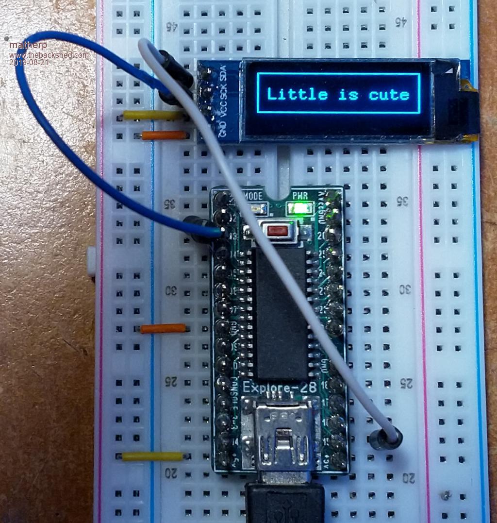

Prompted by an question on an old thread I've updated the ssd1306 OLED loadable driver.
The driver supports 0.96" 128x64 and 128x32 displays - not the 1.3" I2C versions which simply don't seem to work.
To use the driver load the attached code into the Micromite. Edit the code to reflect your usage if required (I2C-address, SCK-pin, SDA-pin, Vertical size (64 or 32), orientation (1 to 4)). Connect the display using the SCK and SDA pins specified in the SSD1306 subroutine call - these can be freely chosen as the I2C bus is bit-banged. Then type "LIBRARY SAVE". Reset the Micromite and you should see the banner
"SSD1306 I2C driver loaded". If this isn't pretty much instantaneous your wiring is incorrect and the I2C bus has timed out.
You can now use all the graphics commands specified in the Micromite manual. Note that any non-zero colour will be white and zero will be black (unlit)
sub mm.startup
 SSD1306(&H3C,2,15,64,1) 'I2C-address, SCK-pin, SDA-pin, Vertical size (64 or 32), orientation (1 to 4)
End Sub

No, should just work. I tested on 128x64 and 128x32 as pictured using a 28 pin MM2. Note 1.3" I2C versions are wired incorrectly and don't work. I'm not aware of any faulty 128x32 displays.

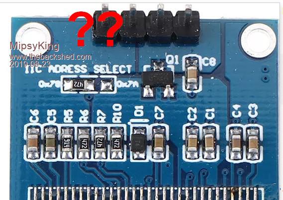

Ok, all working now!    The problem was the back of the display: there is a configuration resistor soldered on 0x78 and the alternative is 0x7A. So I configured your listing for &h78... but it was misleading because everithing started to work when I had the idea to simply dont touch your default setting (so the the real adress is &h3C ?) . I dont know why they wrote such numbers, if is not true...
Posts: 12083
Posted: 07:01pm 22 Aug 2019
  Quote  I dont know why they wrote such numbers, if is not true...
I2C devices have a 7-bit address and the 8th bit defines read or write. There are two conventions, one treats the addresses as 0-254 in steps of 2 and the other 0-127 in steps of one. MMBasic uses the second, your display is using the first.
hex 78 / 2 = hex 3C
