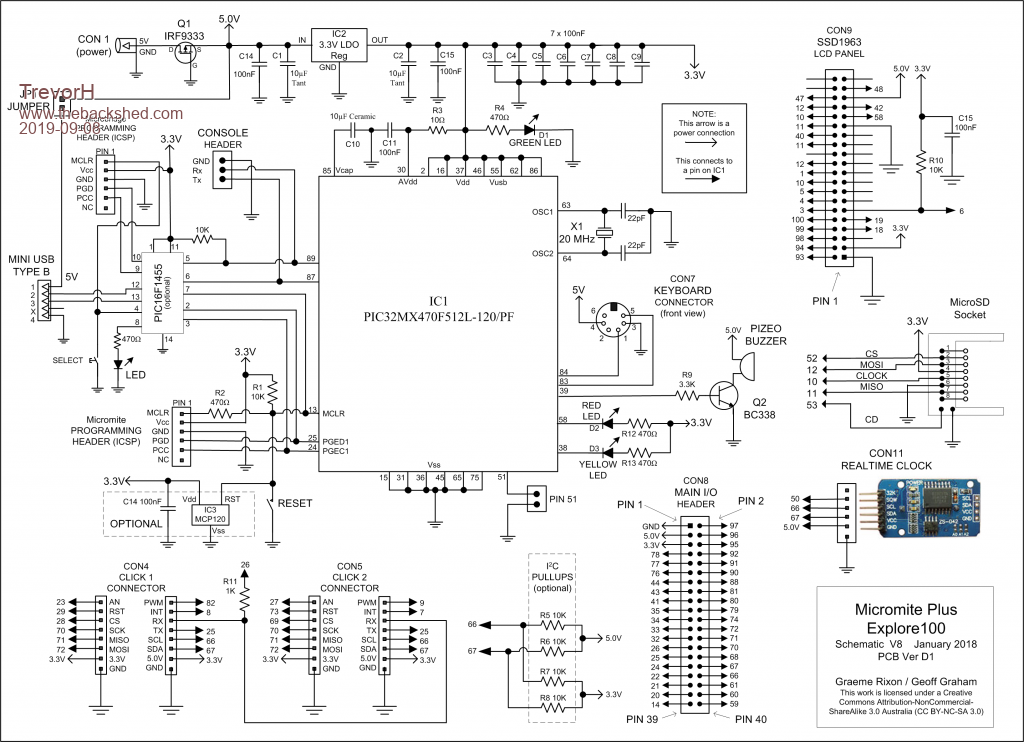

I purchased an Explore 100 that is marked 'Version 1D' on the PCB.
The only schematic I could find for the Explore 100 was marked 'V5 May 2016'.
All the images I could find (where I could see the PCB version number) were either 'Version 1A' or 'Version 1B'.
It is possible the schematic (v5) matches the earlier PCBs (v1A and v1B), but I can't tell, and it certainly doesn't match the PCB I have. It is good to see active development on the design, but the inconsistent numbering/labelling of PCBs and schematics is abysmal!
Wouldn't it make a whole lot more sense to 'version' the schematic '1A' or '1B', or label the PCB 'V5'?
I don't know if Geoff just does the MMbasic coding, or if he gets involved in the hardware at all, but the 'Explore 100' section of his website is very out of date with a picture of the Explore 100 version 1A, and the older 'V5' schematic. There are also procedures/documentation referred to in the user manual which don't appear on the site (at least not that I could find).
Please, can somebody direct me to where can I find the schematic that matches my PCB... the Version 1D?
Thanks,
MM

The version 1D board is (I think) the latest version of the Explore 100 PCB from Rictech in NZ (if it has the SD card connector on the back of the board). It includes a PIC32F1455 chip to allow on board programming without a PICKIT.
Grogster (from RICTECH) is your man for a schematic of this board - he is almost always watching TheBackShed so may well respond.
The latest version of the PCB from Silcon Chip (to my knowledge) was version 1B and the circuit for that is V5 on Geoff's site.

I have PM'd with MustardMan, but just for anyone else reading this thread, some history on the E100:
- The original prototype was the 1A board, that used a micro-USB socket for the power connector.  This board really never made it past me, Geoff, Phil(micromite.org) and I think that Peter(matherp) also has one of those early prototype boards.  The 1A was sold in VERY small numbers to a few people, but most people DON'T have that early board.
- The 1B version of the board changed the micro-USB socket for a DC barrel socket, and there were some internal layer track changes.  The 1B was the board that most people ended up buying.
- The 1C version of the board had the 1455 chip added as a SMD chip, but it was decided that it would be better to make that optional, as many people had already started using external CP2102 USB-serial modules on CON6 on the 1B's, and changing the board so that the 1455 was on it and doing away with CON6 was though to be a bad move, as then all those with the external adaptors would not be able to use them.  I don't think that the 1C version of the board ever made it past prototyping and I am reasonably sure that no-one has that version of the board.
- So version 1D came about because of wanting to make the 1455 chip optional, allowing people to continue to use their external USB adaptors on CON6.  Version 1D allows for the 1455 chip as an optional extra in DIL footprint, and the USB pins on the PIC32 chip have been disconnected.  To use the USB socket on the 1D, you MUST have the DIL 1455 chip installed.  Any kits sold in the future, will include the 1455 chip in a socket, and if you don't want to use it and would rather use an external adaptor on CON6, you simply pull the 1455 chip out of its socket.  It was also decided at that time, to put a micro-SD card socket on the back of the PCB.  Silicon Chip modified my Gerber files to do the same when they published the board, but they put their socket beside the 3940 regulator.  I put mine elsewhere, so as not to infringe on the copyright that SC now held for the board.
As to the schematics, Geoff gave me the initial one, and I laid out the E100 board from that.  Unfortunately, with me doing PCB revisions, Geoff never updated the schematics, and that is not his fault - I should have told him what I did, and he could rustle up a new schematic.  It would be a good idea for the schematic diagram to match the PCB version number, I agree.  That is a bit of a F-up and is understandably confusing to newcomers to the board.
I will draw a new schematic for the 1D soon, and post it here.  I will also email Geoff just in case he does not read this thread.
EDIT: Oh, and on the 1455 drivers for Win7/XP, the driver package from my website should work for XP and Win7.  As you know, Win10 knows about that chip, and no drivers are needed on that OS.  Linux is the same - no drivers needed.  Your XP version MUST have SP3(Service Pack 3) installed.  The driver WILL NOT work on an XP machine that does not have SP3 installed, as it needs some of the changes that SP3 does to an XP machine.  Win7 should not fight you as much as XP might with the driver, as Win7 is newer.  I would sill recommend you have a fully updated Win7 though before making the attempt.  Very early un-updated Win7 machines might have the same issue as un-updated XP machines do.
Edited 2019-09-06 10:56 by Grogster

TrevorH
Joined: 06/04/2018
Posts: 145
Posted: 04:46pm 07 Sep 2019
@MustardMan
Here is E100 V1D.
TrevorH
Posts: 10056
Posted: 01:42am 08 Sep 2019
Yes, this one IS the current version.  It has the 1455 chip and uSD card socket pinouts on it.  I obviously had forgotten that Geoff must actually have updated it back in Jan 2018!
Nice one, TrevorH!
MustardMan
Joined: 30/08/2019
Posts: 175
Posted: 05:14am 08 Sep 2019
@TrevorH
Great!!
Many, many thanks. And it is awesome you've marked in the title box what PCB revision number it is. That will make it so much clearer to newcomers (like me).
MM.
