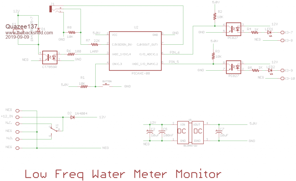

Personally I would add a 10nF at Vdd of the PICAXE08M2. Not sure how good the 10uF alone works.

Agree that C5 should be on the other side of the DC-DC module, as close to the picaxe power pins as possible.

 In cleaning up the schematic I lost the other cap but then you know how easy it

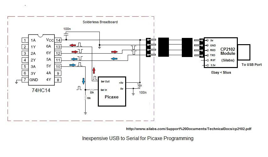

Here is somebody's usb/serial CP2102 to picaxe inverter using a 74HC14:

USB serial cables with a PL2303 in them do work. I have used several (from ATEN) with older chips, and newer (in W10 that means you have to install a different driver).
I run Linux (Lubuntu 18.04) and these work flawless. No need for different drivers whatsoever.
The only time you may need to help the software download to the 08M2 a bit is when you assigned a different function to the serial communication pin (because you ran out of pins). The 08M2 has only 4 otherwise... In some applications I needed a 5'th pin.
As mentioned by lizby, it has to do with the break. The USB chip should be able to hold that break indefinitely. Some chips time out after 1 character.
This one works

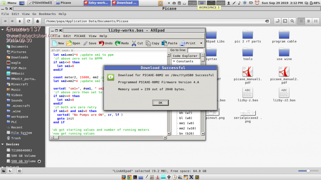

Posted: 09:46pm 29 Sep 2019
Update here

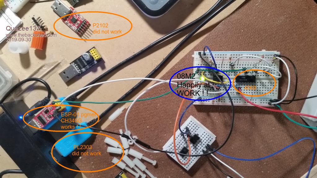

 The three Picaxe 08M2+s showed up. I tried a few USB to Serial converters none
 wanted to work. I was going to order the cable and looked at my ESP-01 USB to
 serial sitting there and said HAY why not give IT a try.
and YEA !! it worked.
 The parallel coding was not working so went to standard fall through coding.
 This is working really well. It takes 30 seconds to test if meter/s
 is above 8PPM. If only one is the other is tagged at zero.

symbol light = C.4
symbol gm1=w1
symbol gm2=w2
symbol sm1=w3
symbol sm2=w4
symbol bh=w7
symbol bl=w8
symbol mm1=w9
symbol mm2=w10
symbol bn=b26
symbol n=b27
init:
sertxd( cr, lf, "getting sm's " )
' get startup values
count meter1, 15000, mm1 ;get count for 15secs
let sm1=mm1*4 ;update sm1 to ppm
'if above zero set to 8PPM
if sm1<>0 then
  let sm1=8
endif
count meter2, 15000, mm2 ;get count for 15secs
let sm2=mm2*4 ;update sm2 to ppm
sertxd( "sm1=", #sm1, " sm2=", #sm2, cr, lf )
'if above zero then set to 8PPM
if sm2<>0 then
  let sm2=8
endif
'if both are zero retry
if sm1=0 and sm2=0 then
  sertxd( "No Pumps are ON", cr, lf )
  goto init
end if
'ok got starting values and number of running meters
'now get running values
do
  sertxd( "getting gm's " )
  let gm1=mm1*4 ;update gm1
  let gm2=mm2*4 ;update gm2
  sertxd( "gm1=", #gm1, " gm2=", #gm2)
 'if gm's are above sm's
  if gm1=>sm1 and gm2=>sm2 then ;
    high light ;then light on
    sertxd( " Lite ON", cr, lf )
  else
    low light ;else light off
    sertxd( " Lite OFF", cr, lf )
 endif
loop
Now wiring up a 28 pin Ziff socket and and 8 pin cable to go to the ESP-01
USB to serial and work with all the Picaxes.
Thanks lizby for the help.
