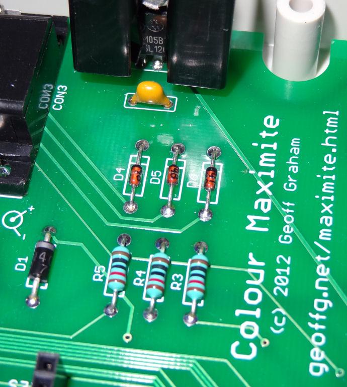

Hello folks,
I've just finished building my Colour Maximite (thanks to Phil @ www.micromite.org) and fired it up for the first time attached to a VGA monitor.
The image does not the crystal clarity I have come to expect from modern computers, is this to be expected? There is nothing I can sucessfully capture on camera but characters seem to have a very slight blur to them, more noticeable in Mode 4 than Mode 3. I guess the image is still probably better than I remember from an 8-bit computer attached to an old TV, but I'm wondering if it something I haven't managed quite correctly in the construction.
Any opinions/suggestions?

Are you sure you assembled the Maximite with the correct resistors and the diodes the right way round on the VGA output part?
The idea is that the red, green, and blue pins for VGA vary between 0V and 0.7V.  Because the CMM is only eight-colour, it wants those pins to be either high or low, and it does this by using relatively low value resistors (120-Ohm) with 1N4148 diodes that clip the maximum voltage at or below 0.7V.
If you use slower diodes then they don't switch fast enough and that results in a fuzzy picture.  If you've fitted one or more of the diodes backwards, then the voltage will be driven above 0.7V which is outside the VGA spec and also results in a poor picture.  The black bands on the 1N4148 diodes should be on the side nearest to the voltage regulator.
Also, it's easy to fit resistors with too high a resistance that will produce a feeble, dimly-coloured picture.
Those four-band resistors are a nightmare.  Depending on which end you read them from, Brown, Black, Black, Red, (Brown) is 10K with the last Brown meaning 1% tolerance, but from the other (correct) end, Brown, Red, Black, Black (Brown) is 120 ohms, also 1% tolerance.
I almost always check the resistance of resistors using a trusted multimeter - apart from the stupid ambiguous colouring scheme, I've seen resistors that were just totally wrongly coloured: I've kept one somewhere that is almost exactly 220 ohms (should be red, red, black, black, brown) but is actually painted yellow, violet, black, red, brown - 47K!
Make sure you have the correct 120 ohm ones fitted (150 ohm would also be okay).

Thanks Ceptimus, I'll check all this when I can escape from the family for 30 mins ;-) All the parts came with the kit from micromite.org and I tested the resistances as I installed so I'm reasonably certain I've got it right ... and would expect more obvious prolems if I hadn't. To be honest I think Mauro had the correct explanation.

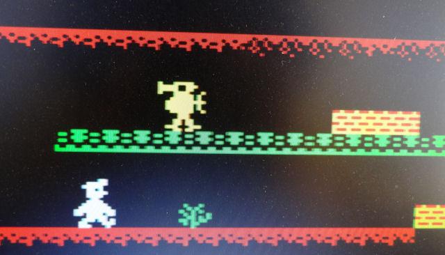

I've used my CMM on several LCD monitors, and the picture is pretty sharp - better than most vintage computers from the 8-bit era, but not as sharp as modern kit.  I also tried my CMM on an old CRT display and it didn't look any better.
I agree with Mauro about playing with the monitor menu settings - especially to try and get a 4:3 aspect display.  On a modern 16:9 or wider monitor, that will leave you with black bars up both sides of the display, of course - but you'll be seeing the picture that Geoff, the CMM designer, intended.
[aside]
CMM pixels aren't square, even with a 4:3 monitor - they're wider than they are tall, height being about 83.3% of width.  Their width:height ratio is 6:5
The non-square pixels are the reason I wrote my PTETRIS program in Mode 3 - that way I could make the tiles 18 pixels high and 15 pixels wide to make them appear square on standard monitors.  In mode 4, I couldn't make them square and keep them a reasonable size.
[/aside]
Here are some photos I just snapped of the screen.  This is with a cheap Acer KA220HQ LCD monitor.  I really should have wiped the dust off the screen first!

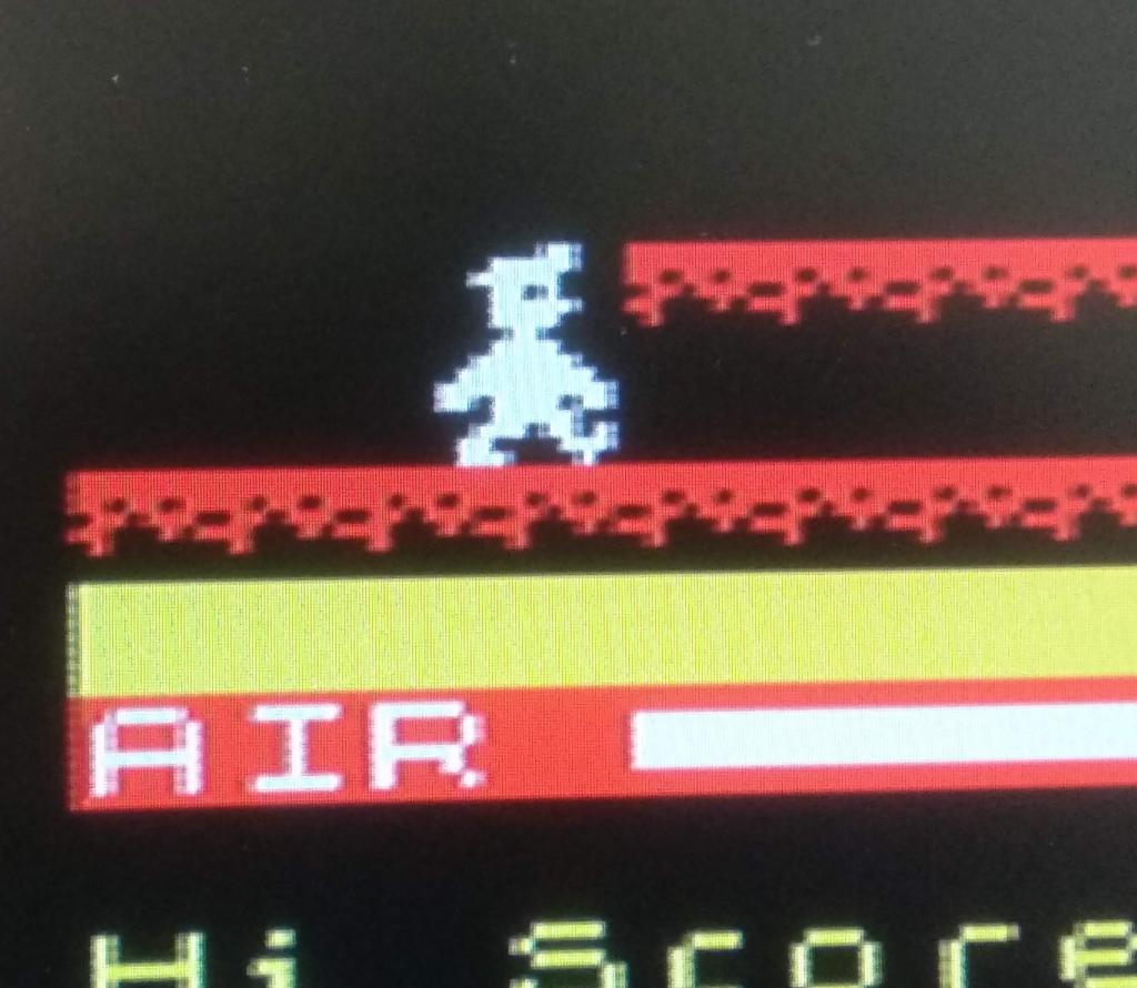

Your LCD has a very stable image, but when I say about the quality, we can see in the image below the irregular scaling effect:
Look in the M letter, you will see that the vertical lines are not the same width for the same letter in another position on the screen.
The letter X has the same problem, which doesn't have uniformity in the diagonal lines, and I sure that the same letter in another position will sometimes have perfect diagonal pixelated lines.
This is not a CMM bug, it's like I said before, it's just the digital display trying to scale a not standard resolution, and on an analog display, these scale effects don't occur.
I used very old LCD monitors on the CMM, and some have a little color shadows effect with some small flickering, and others have a perfectly stable image. Only on a CRT I see a crystal clear image without any scaling misalign, but when I use blit command to scroll colored images too fast it's possible to see the colors out of sync because the CMM doesn't put the three colors at exact same time and doesn't use VSYNC or a frame buffer.

I've checked the diodes and resistors, and I've wiggled the connectors to no avail, pixels (especially in Mode 4) still have a "shadow":
