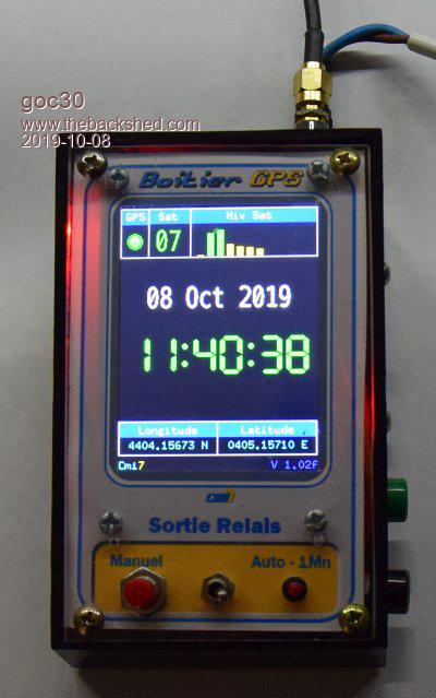

more generally, I think you have not understood the architecture of my program. the goal is to lose as little time as possible to read the received frame and only to store it in a rotating stack, then when there is time available, ie between two receptions of characters, we continue the work of depilation and in the right boxes.
The main loop can be interrupted as many times as necessary, it does not matter. But provided that the receiving routine leaves free time and does not take up too much CPU time. but in my case, it is this problem that annoys me. And so if, as you put it, I wait for the end of a frame to treat it, I have all the more characters to arrange, and so in this case, I would lose even frames. I tested your solution, and that's what happened to me. the more time you spend in the re-capture routine, the more chances you have to have overlapping frames.
remember that the interrupt generated by the chip does not go directly into my routine, but goes through a MMBasic layer, and what does this layer ??, you know?
What guarantee do I have that with the stop code(10), there will only be one interrupt or that, as I think, there will always be an interrupt with each character processed by MMBasic, and it's only MMbasic who after these treatments, will call my routine at the reception of the stop code. And  how many time is used by MMBasic to process internales interrupts?
Also, I know that in "UART by interrupt" pogram writing in "C" and given by Microchip, it is necessary to mask interrupt bit when you receive a char. Is it same case in MMbasic??
  panky said
If none of that works for you, you could write your own CFunction or better still, move to another language.
I have also other GPS programs in other langages (Asm, "C" ,Pascal, Python) on other platforms. My choice depending of necessity to have more or less graphicals capacity and others reel-times process (like trip-master, car speed, alarms,etc). If I choice MMbasic, it is for simplicity (1 mx170/470 +1 GPS + 1 rtc + 1 tft 2.8"). My error is to think that a cpu (mmx470) who work at 120mghz can do more than an arduino in 16 mghz

Posted: 09:50am 08 Oct 2019
my proto box
