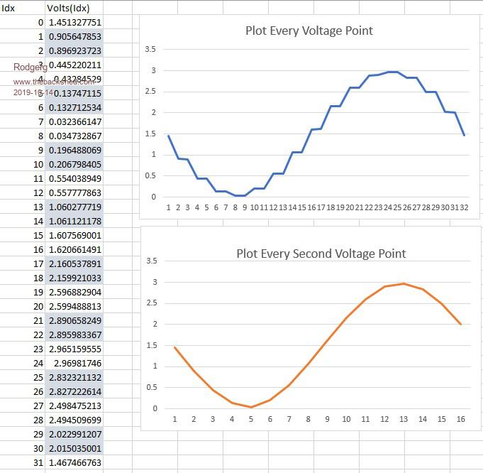

I injected the following waveform into Pin 34 on the Armmite H7 (50 Hz sinusoidal, ranging from 0V to close to 3.0V)
While the background ADC program correctly collects 32 samples, I noticed that adjacent pairs of readings were very similar and this resulted in a strange stepped output when plotted. However, if I plot every second point (meaning only using 16 points), the waveform looks much more as expected.
A listing of the program output and the resulting waveforms are shown below.
Adjacent pairs have been shaded to demonstrate the issue more clearly. It is almost as if the second result of each pair is taken immediately after the first reading, rather than waiting for the next scheduled time .
I have tried two different Nucleo Boards (H743ZI and H743ZI2) and different versions of matherp's firmware (this output was produced by using the firmware file 2019-09-15_191616_Armite1.3), but alas all with the same result.
If anyone could point out what I may be doing wrong, that would be greatly appreciated.

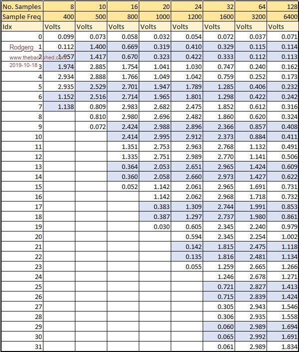

I have now had an opportunity to run a series of tests and have documented the results in the table below.
The same grouping effect mentioned in the earlier post is exhibited in a range of sampling frequencies between 400 Hz and 6400 Hz, including a couple of non- 2**n sample rates.
Please note that for the 64 and 128 samples per cycle tests, I truncated the list at 32 to save space in the post, but the complete sample was still present in the background.
Interestingly, the 8 sample test showed a slight offset in the repetition pattern (as shown), but this was somewhat random when I repeated the 8 sample numerous times. Sometimes it appears on [0,1],[2,3],[4,5...], but at other times it looks similar to the higher order sample rate tests orders [1,2],[3,4],[5,6]….
However, when I ran a large number of 16 sample tests, I did see some variability there too, but the majority of results repeated the pattern highlighted rather than the alternate one.
I hope this is helpful and would appreciate any further pointers

Just one thought before I try and set up a test environment: What is the impedance of your source? It needs to overcome the ADC input capacitance between samples and if too high will give issues.

I've been able to replicate and there is a bug - but at the moment I don't understand the cause. I'll keep working on it but a workaround is to double the frequency and use every second sample.
