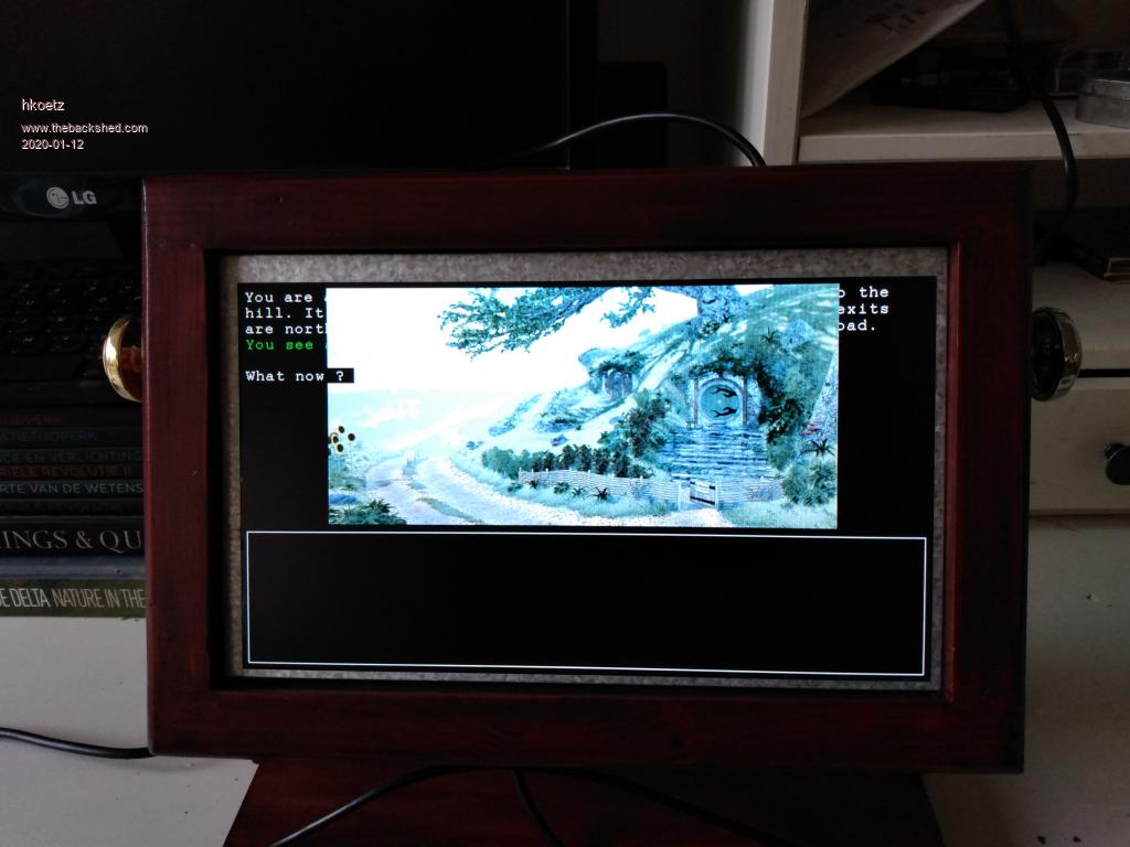

There is a picture on the top half of the screen (LOAD IMAGE). On the lower half is varying text (generated wint PRINT). Is there a way to clear the lower half of the screen only, keeping the picture on the top half in place. I have OPTION LCDPANEL CONSOLE active.

BOX 0,MM.VRES\2,MM.HRES,MM.VRES,,0,0

The attached photo shows what happens. How do I print and clear inside the box?

I get it. You paste a box filled with background colour over the text.
Thx
Posts: 11973
Posted: 03:42pm 11 Jan 2020
Not sure what you are trying to do. If you want to constrain the console to work inside the box it can't be done. In a program you just use normal drawing commands as per the MM2/MM+/MMX manuals

Sorry but I have not use the BOX command yet. But if you use [lw] = 0:
BOX 0,MM.VRES\2,MM.HRES,MM.VRES,0,0,0
Does it draw a box without a border? If so can you use:
PRINT
PRINT
PRINT
To clear the area and position the cursor to where you want it?
