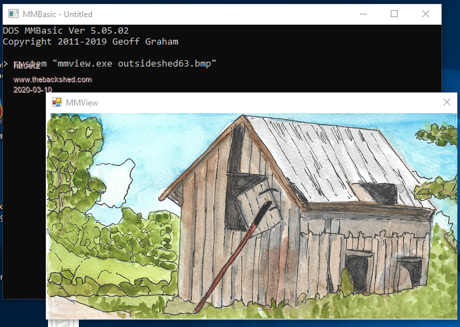

I appreciate TassyJim's MMExtra to play sounds from MMBasic for DOS. Is there a similar way to open a window and show a picture in it, e.g.
System "MMView.exe TestPicture.bmp"
Obviously MMView would have to be developed. Any tips on how to do this?

Thank for the input Matherp. The method works well. However, all imageviewers I found have far too much functionality. So I made my own (MMView). Its use is shown in the picture.
One problem though. You do not return to the MMBasic prompt, unless you close the picture viewer. Any thought on how to remedy this.

This should work (system "call start e-28.jpg" works for me, returning to the ">" prompt when interactive).
system "call start mmview.exe outsideshed63.bmp"
Maybe you don't need "start".

Thx Lizby, that works. You don't need call. So the syntax is:
system "start mmview.exe outsideshed63.bmp"
